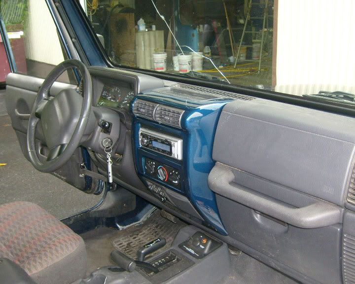

Man........I just did my center dash bezel today because I wanted to be different. Now this post pops up and I feel like a sheep. Well I did go a little bit different. I called Napa and had them mix me up a 1/2 pint of Patriot Blue Pearl. I cleaned the surface, sprayed it with adhesion promoter, and mixed up my paint. I sprayed mine with a touch-up gun for a little better finish. For a couple dollars more Napa will mix your factory color and put it in a rattle can if you don't have access to paint guns.
I will find out in the morning how it turned out. If it is good I will post pics.

post #70 of 183 Old 07-22-2009, 10:47 AM
Photog2000
Location: Wisconsin
Posts: 1,122
Originally Posted by Cole99 View Post
I did not know that. Interesting. Yes, please post pics, because I've been stymied as to what to do with my, currently, black plastic center console cover.
Here you go. There were a couple of bugs stuck to it this morning but I guess I'll get over it.

post #71 of 183 Old 07-22-2009, 11:36 AM Thread Starter
Cole99
Location: Columbia, South Carolina
Posts: 199
Wow. I know what my next project is. That looks fantastic!

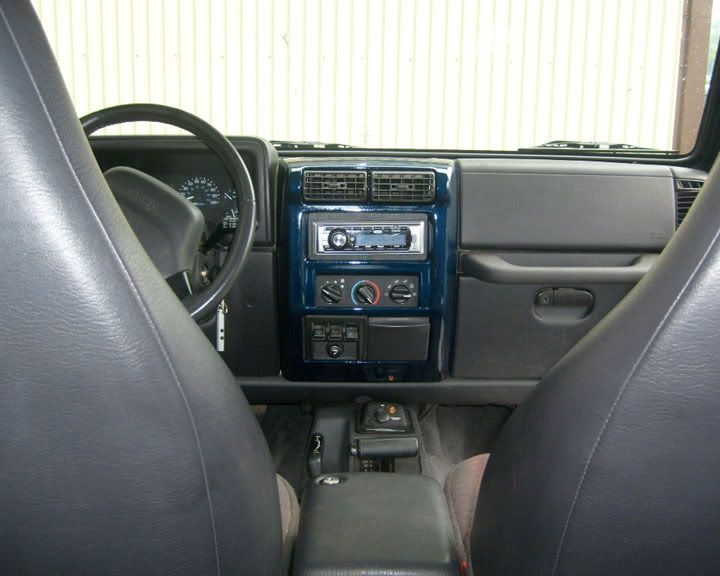

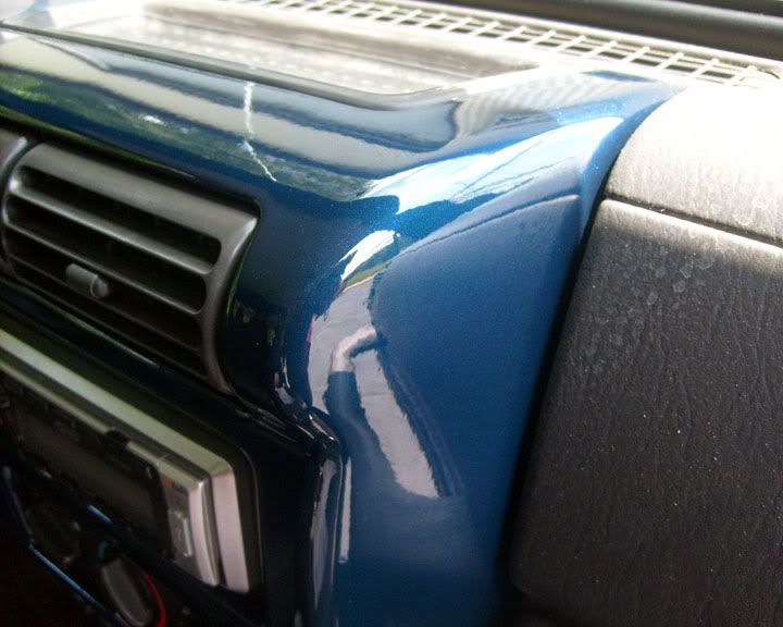

post #74 of 183 Old 07-22-2009, 02:52 PM
Photog2000
Location: Wisconsin
Posts: 1,122
See if this helps. This crappy camera at work sucks. It is a perfect match in person other than one being fresh and the other 9 years old.
Mine does not have a CB if you were refering to me.
