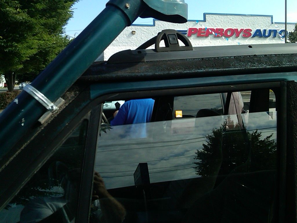

While I was out and about the other day - at my not so local Pep Boys there was a green XJ just like the one I gave away last month

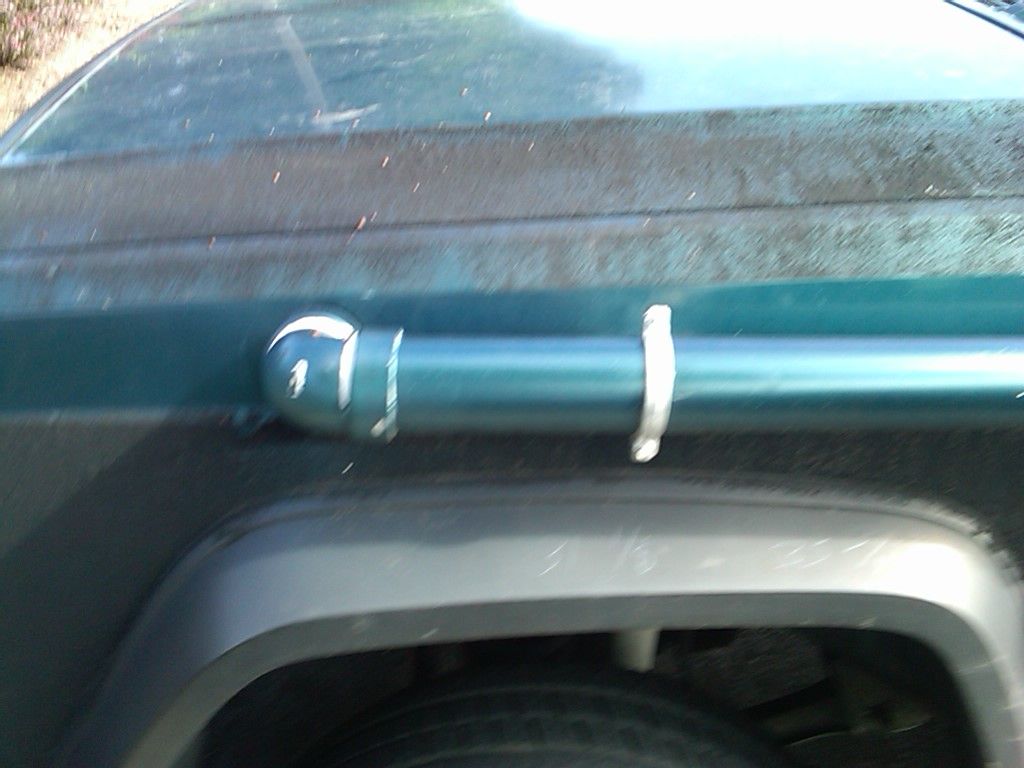

The kid installed his own snorkel set up -- PVC painted to match ( kinda ) electral conduit stand-offs for mounting ( good idea ) --- and at the top --- one of those fittings you see on a house where the power wires actually come to the house - instead of a 45 or 90 elbow -- kinda neet
( crap-berry pics )
I sugested to the kid ---- by having the scoop behind the pipe - its blocking the air flow - if not creating a partial vacuum at the intake ?
If he mounted a bolt and wingnut through the whole assembly -- he could mount it forward of the pipe for a little ram-air effect --- then spin it 180 for mud time

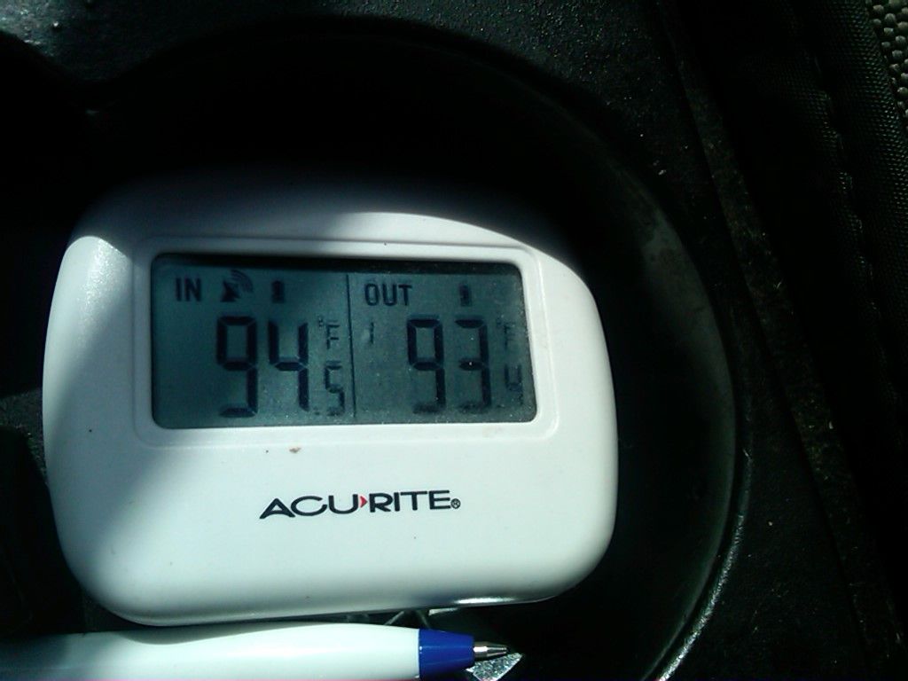

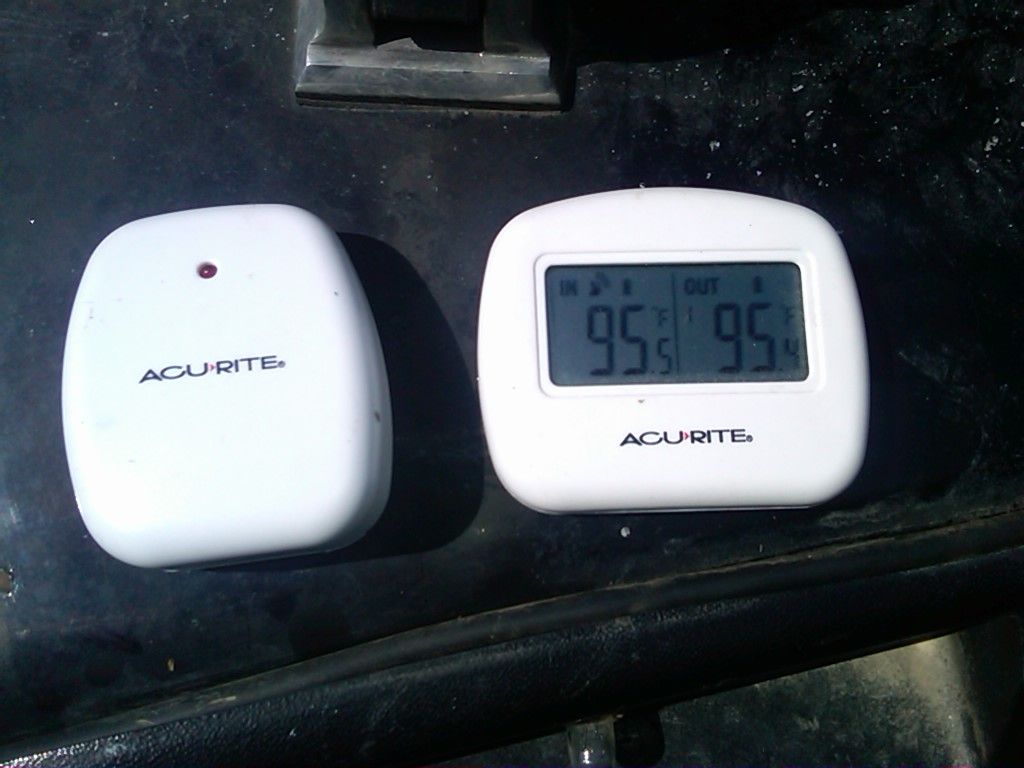

Here is the "Acu-rite" thermometer thing-ie I use to monitor my attic temps - on the Jeep fender to show both the reciver and transmitor regester the same -

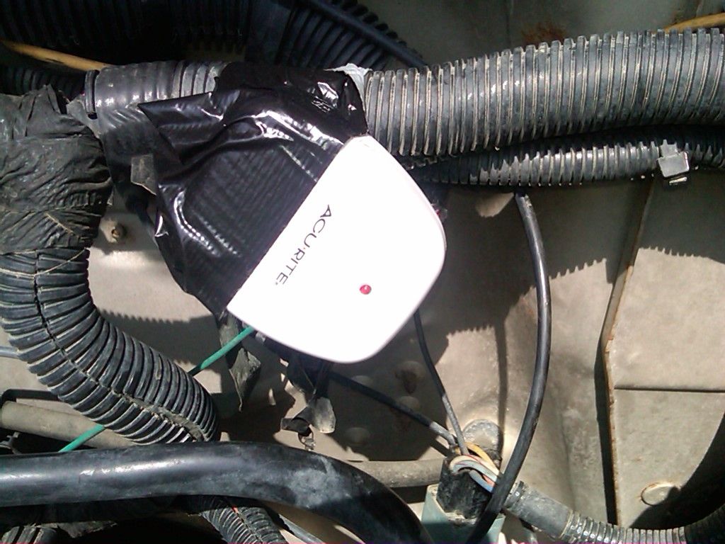

With the transmitor taped to a wire harness @ the firewall --

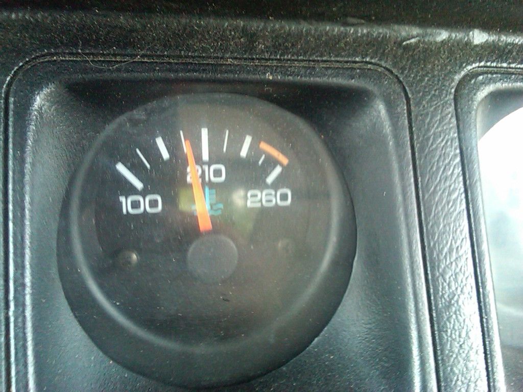

My average cooling system temp didn't go over 210 degs. --
Average stop and go under hood temp 101 degs. --
On the highway @ 55 MPH --
Not as hot under the hood as I thought it would be
