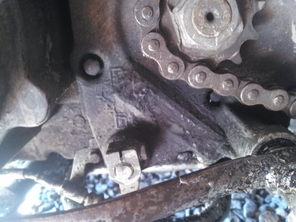

Used it to repair a hole in an engine case on my atv.
Kawaski Lakota popped the chain and took out part of the casing where a bolt secured it.
Cleaned the hole well and used a piece of metal to cover the hole, the hole waS about 1/2'' by 1'' maybe. Used jb on the outside and inside to hold in place. has been working for 3 years now.
