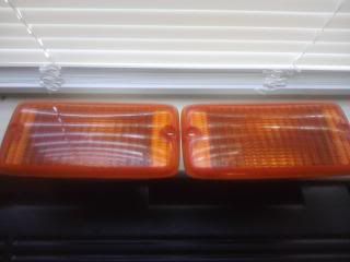

I took off my old faded turn signal assemblies and I hit them with some Pledge furniture polish and a buffing wheel on a drill and they came out great. Not as good as new ones but it worked wonders(COST $0.00 because I had both the furniture polish and the buff wheel)

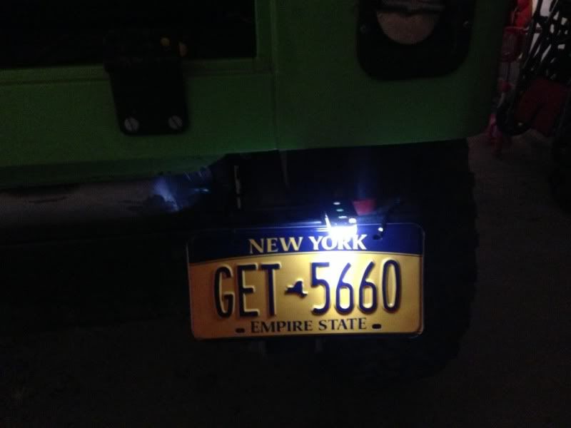

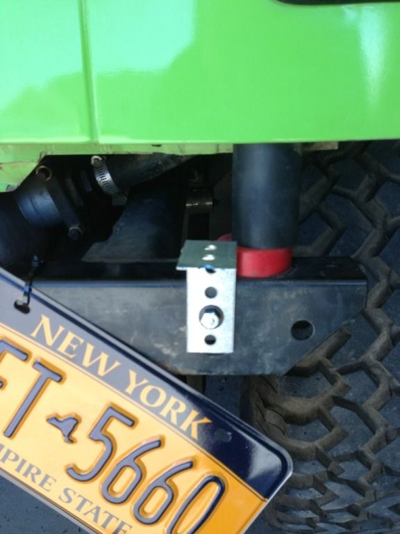

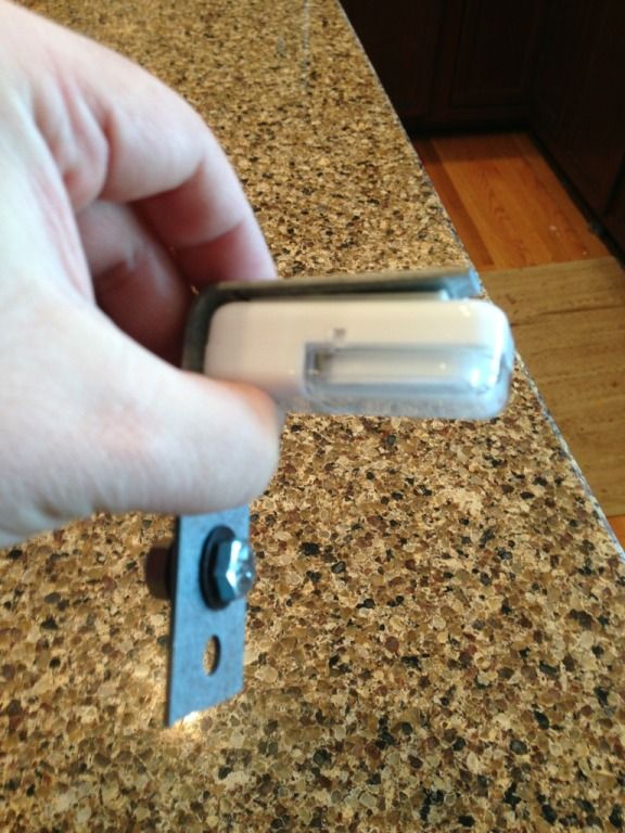

$10 License Plate Light
I needed a license plate light for the NY state inspection since the original was eliminated when flush-mount LED brake lights were added. I picked up some cheap drawer lights at Home Depot and used some scrap aluminum left over from the garage door opener install. I estimated around $10 in materials, but my out of pocket was only the $4.97 for the lights as everything else was already in hand.
