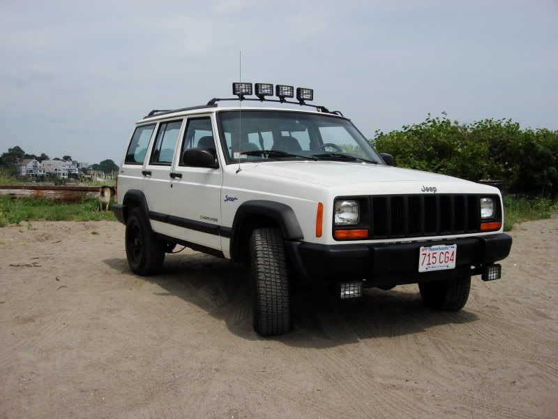

As for my under $100 job... I took the front roof rack bar for my XJ and pulled it off. Got two sets of baja lights from wally world for $40 total. Spaced them equally and then I drilled holes through the metal of the bar and mounted the lights. Smaller holes next to them drilled out and lined with a rubber grommet each let me thread the wires through the bar. Add a little bit of wire loom b/w back of light and bar and end result is a clean looking inexpensive, professional looking light bar for your Jeep. As for grounding, I grounded each light to its mounting bolt through the bar, and the bar to the roof rack at the torx screw in the front holding on the plastic end cap. Power Wire runs through drivers door jamb insulation and under the trim, all is covered in wire loom
here it is on top my XJ:
