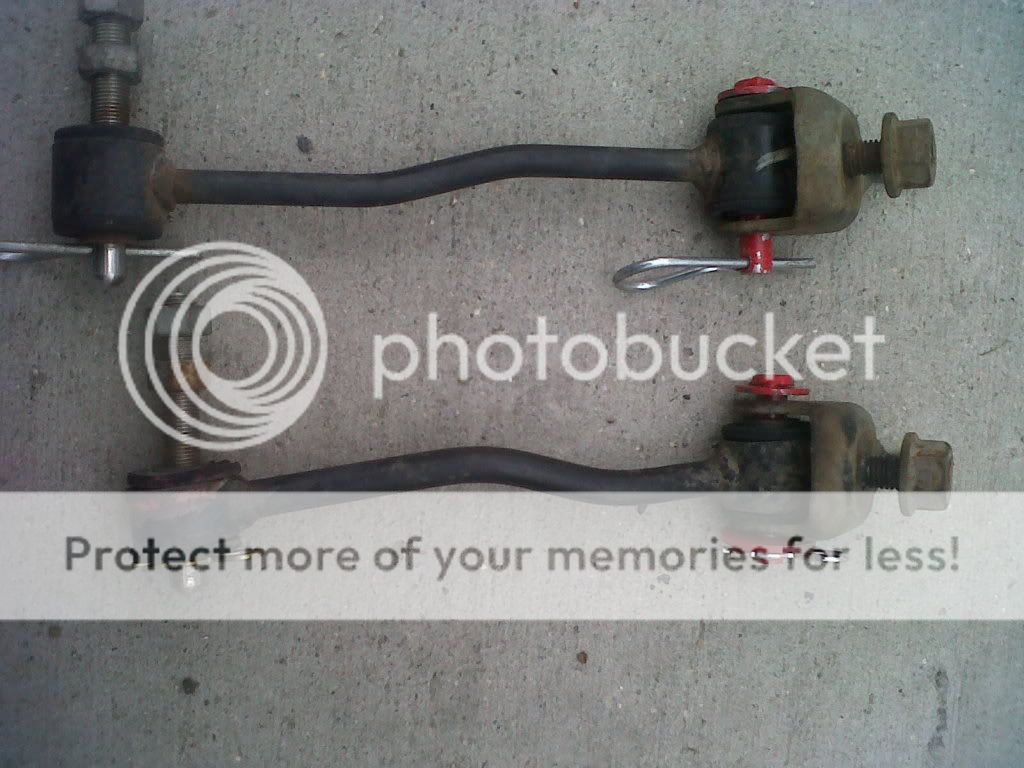

I made a set of removable front sway bar disconnects. Buy using a rear lower shock adapter that is found on 00 mustangs or so. The part could be used for a front shock adapter too. I used sway bar links from a wj, they are a double eye style link. And for the lower axle side bolt you use a 12mm grade 8 bolt with the head cut off. Drill a hole cross ways through the bolt for a pin. And double nut the bolt inplace of the factory torx boltz.
