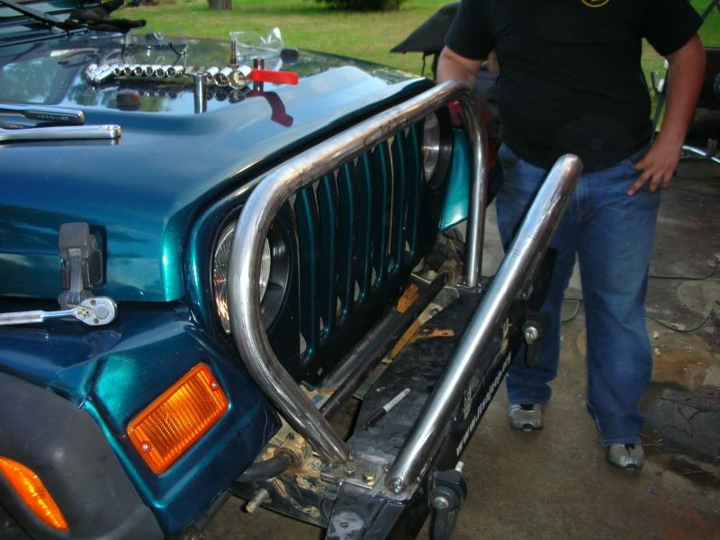

Built the grille hoop and stinger for $40.00 in parts and wire. A friend had the welder and wanted the practice.
Tacking in place
And how it looks all mounted up with winch and lighting back in place.

That isn't me. He was just taking at that point so just shut his eyes. The welds on those plates actually came out really nice.
One thing we had to do was with the grille hoop. With the winch plate stopping before the sway bar bushings, we had to extend that plate as much as possible while still making the sway bushings accessible. With that, the hoop was too far out, so we put a slight lean to it to put it closer to the hood/grille. PERFECT for getting hands in there to pop the hood.
The penetration on the welds was VERY good - it's going to take a SERIOUS hit to move that sucker now.
He's been doing a design on his TJ for a bit (besides doing a custom cage), and it's looking pretty good too. But he's also tackling herculiner, the cage, bumper upgrade, new seats, harnesses, axles, fenders.... it hasn't moved under it's own power since August. hehe

He did use a mask for the weld lines, just not all the tacks.
From what I understand, box tubing isn't as strong as the circular DOM tubing. Basic geometry tells us that round has an overall stronger structure...

Oh I hear ya on that. If you're wanting it for looks, I don't see a problem, but if you're wanting something that'll stand up, round DOM would be the way I'd go. Remember, your cage is round too!
I've seen YJ's with a similar setup, and it looks good. The square headlights let you have the support tube between the two be a little more level than I did mine - I wasn't willing to block my headlights with the tube since it is a daily driver for my son for now (until I get him a 1976 Chevy Monte Carlo ).

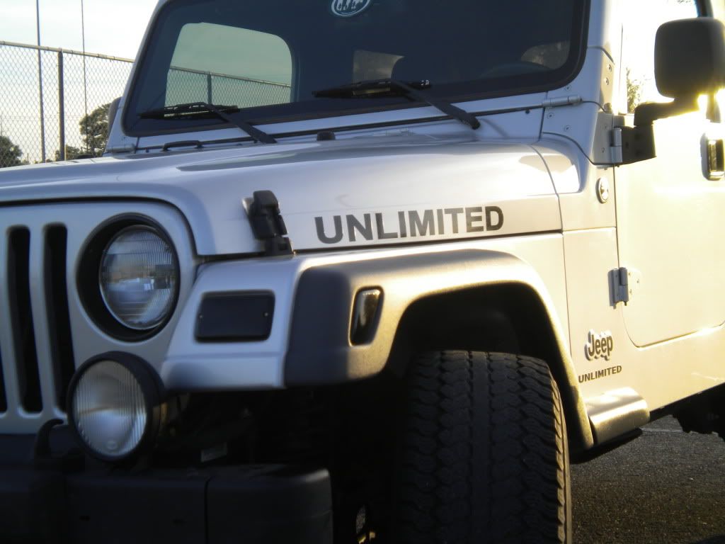

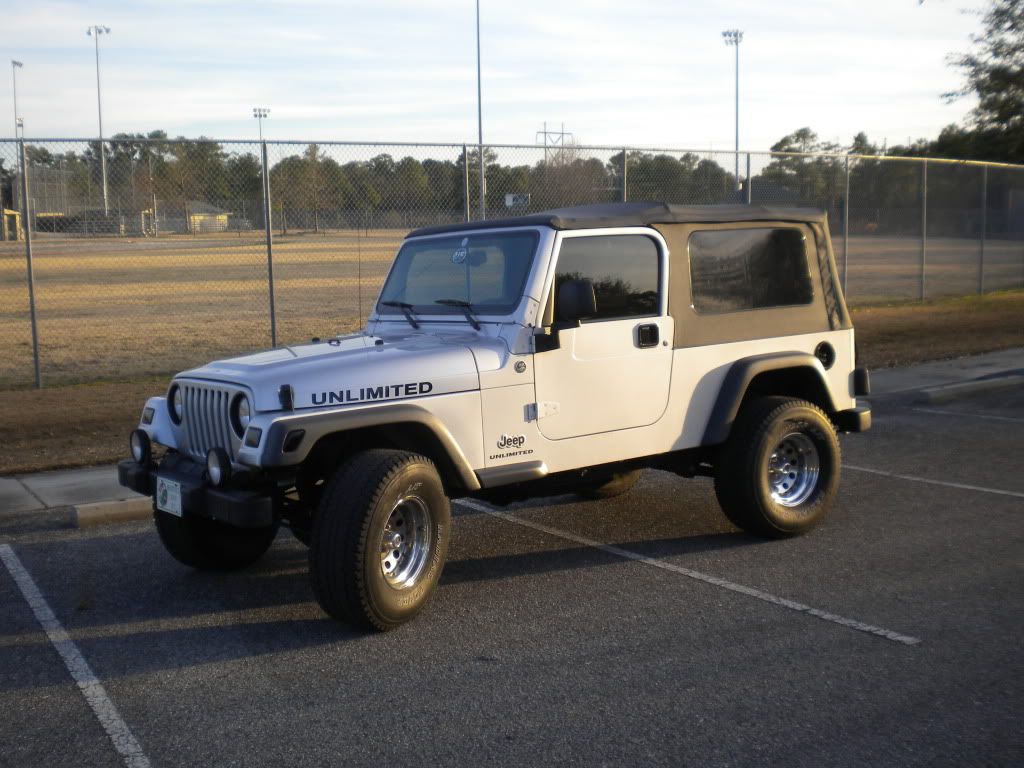

I'm the king of CHEAP
I did all the basics with the rattle can, headlight bezzels, door handles, diff covers......$6
Nite Shaded the signals and markers $12
Also got Wheels AND 33x12.5 Tires for $100
UNLIMITED sticker for $21
2" BB, traded for a CB that I got for FREE
Windows tinted for FREE (friend knows owner of local tint shop)

used VHT Nite-Shades (got it at advance auto for like $12), VERY easy to do just make sure you do it when it is warm out or it will look like crap, and use thin coats. Spray, let dry for an hour spray again, let dry..........I like the black out look.
