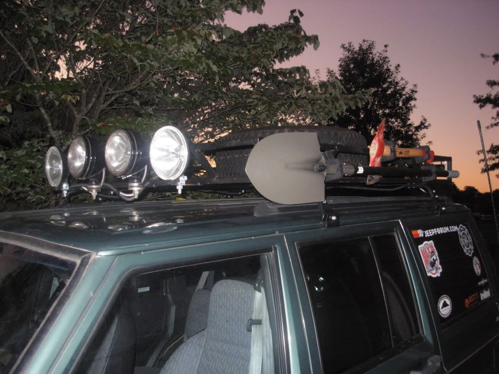

$60 rock sliders
Roof rack ~$80

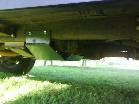

It is 2x2" 3/16 thick box. Very similar in design to JCR's Stage 1 sliders if you check those out. I Used some 1"x3/16" flat for the pinch seam and 1x3" between the slider and the 'frame'
You can see a little of my front mount here. the pinch seam mount is welded to the 1x3
That reminds me, the t-case skid in the pic was free except for welding materials I already had. It was some scrap 3/16" plate from work

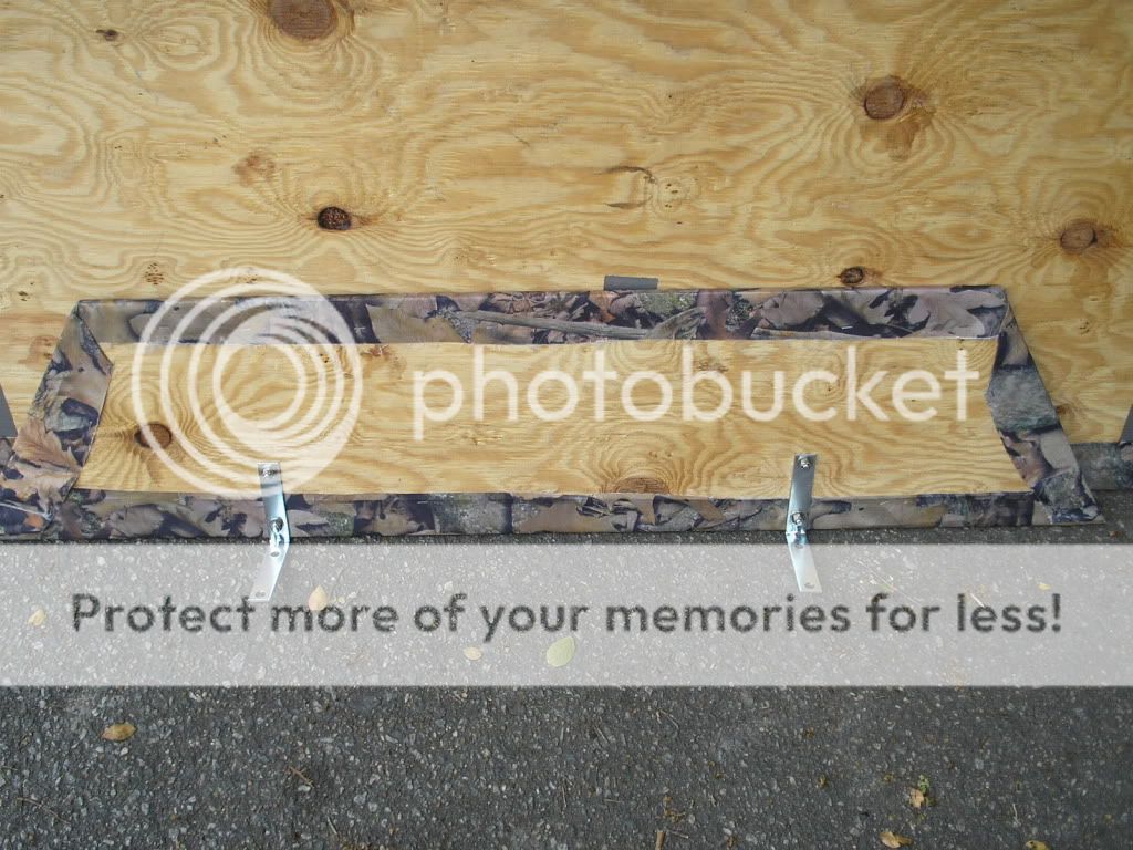

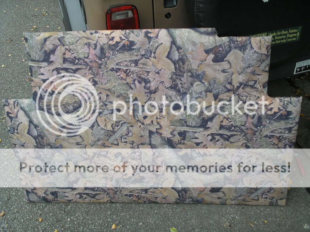

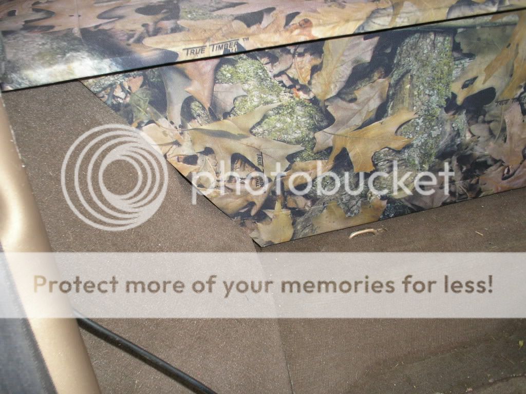

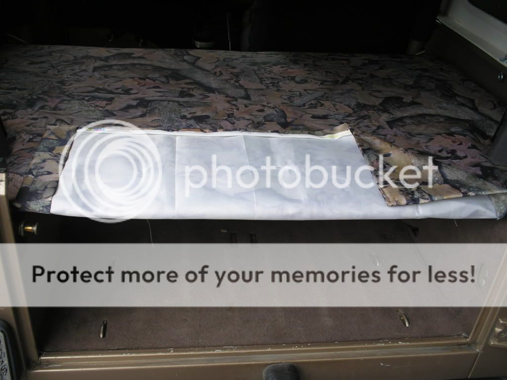

Trunk Storage

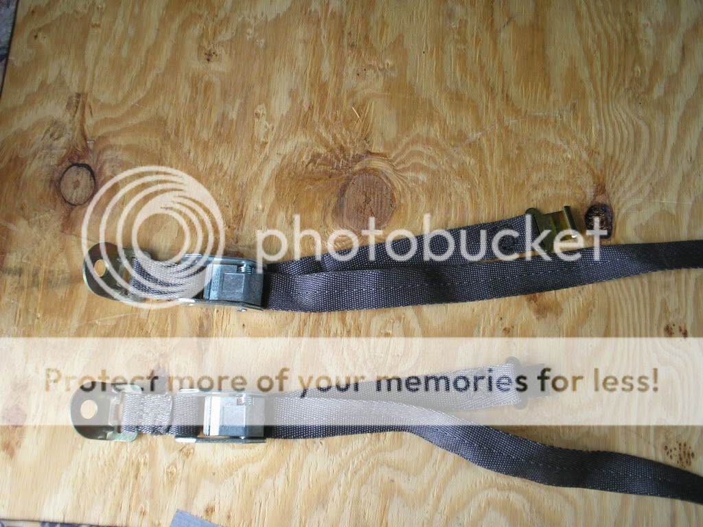

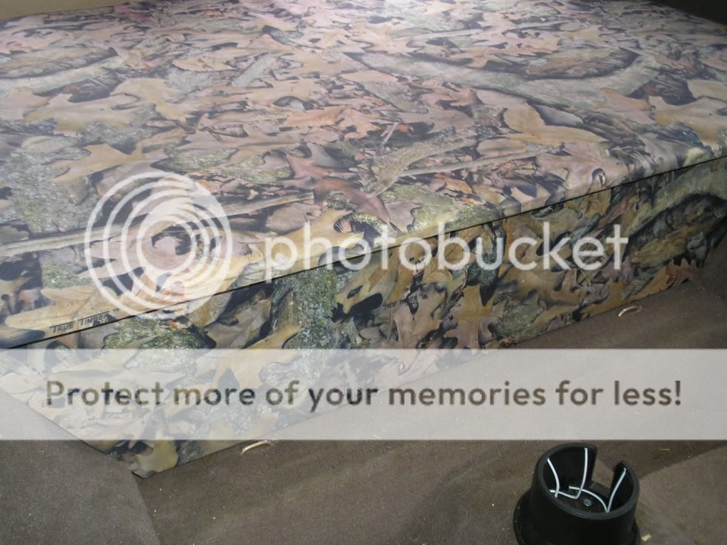

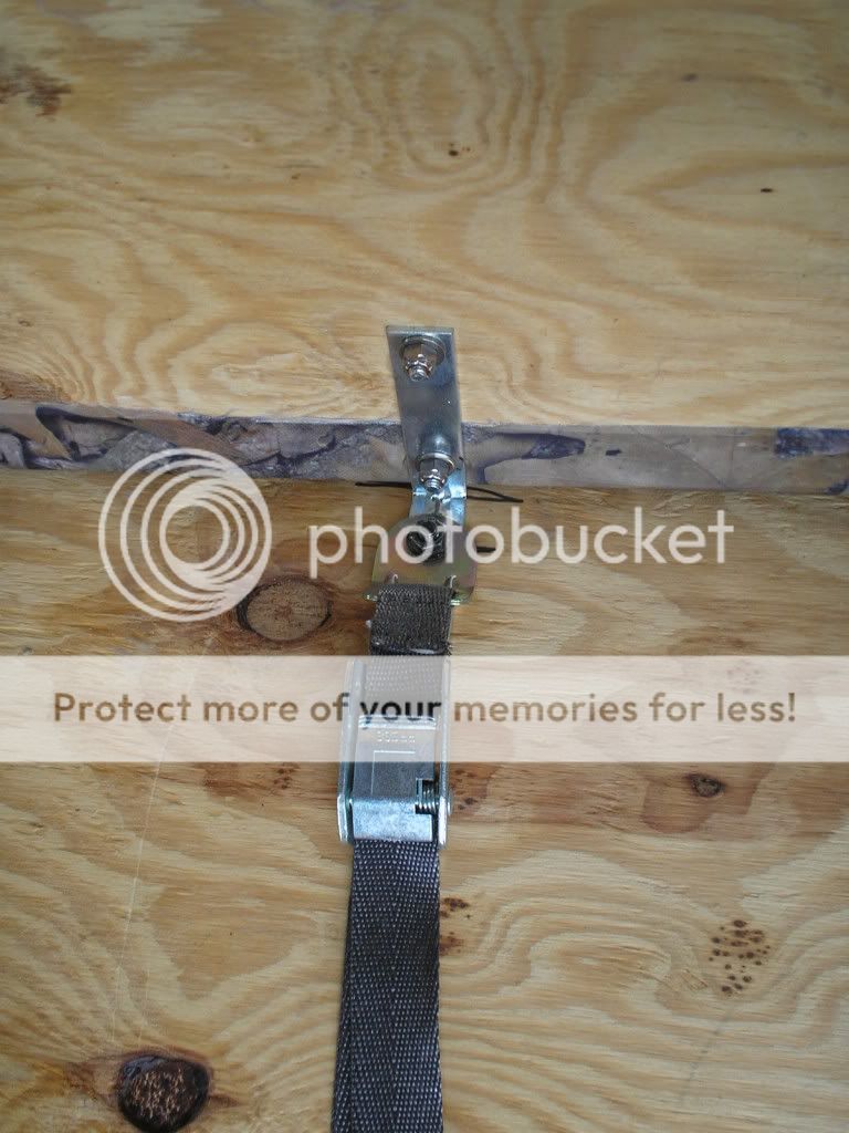

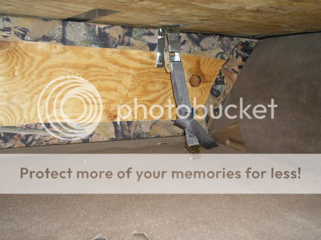

I posted this on another thread. Cost me about $15 (Scrap Plywood = free, tie-downs = free, L-Brackets = $3, Upholstery Material = $12).
I removed the rear seat and seat belts, never use them anyway. I used cardboard to make a template. The plywood is 1/2" scrap that I had in the garage. My top piece measures 36" (front to back) x 54" wide. It is notched for the roll bars and tailgate latch. The piece covering the front started out 36" x 12", I used the template to get as much covered as possible. I covered the top and front pieces with heavy-duty upholstery material. I used stove bolts on the L-Brackets, the heads are under the material. The tie-downs hook into the bed loops that are already there. I also added a rear cover (curtain) because I didn't like people seeing inside the trunk everytime I opened the tailgate. Since it is just a curtain, it is easy to flip out of the way when I want to get inside. I have hauled many pounds of groceries, building materials or tools on top of it without any trouble.
