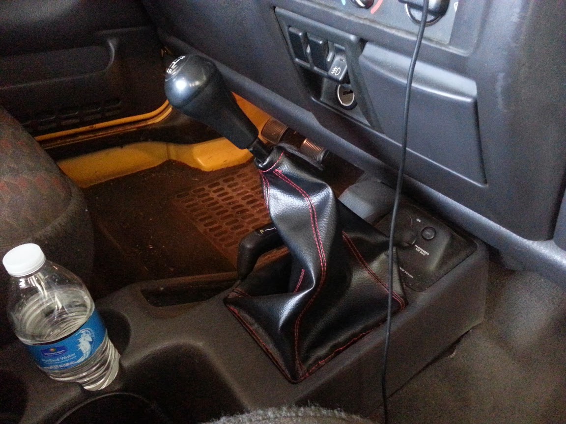

After installing my $75 body lift, I was having issues shifting into 2nd and 4th gears. Solved that for $10 with a new shifter boot from autozone.
