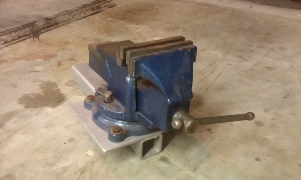

Originally Posted by holliewood61 View Post
Took some scrap 1/4 inch plate and some scrap 2x2 .250 wall square tube and made a mount to put a cheapo vice on and be able to slide into the reciever hitch for trail repairs. Keep it in the instatrunk when I don't need it, pop it in the receiver when I do. Scrap metal from work = free. Cheap vice from the gypsies that come by the shop = $45.
Great idea! I like!
