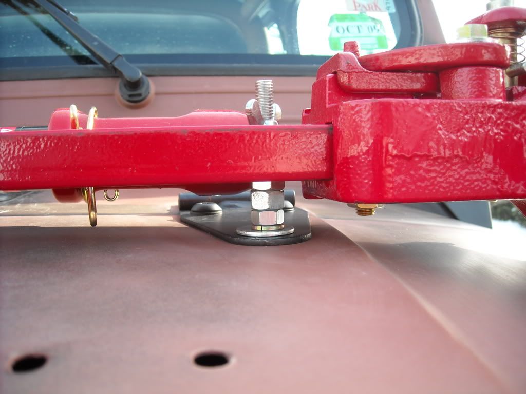

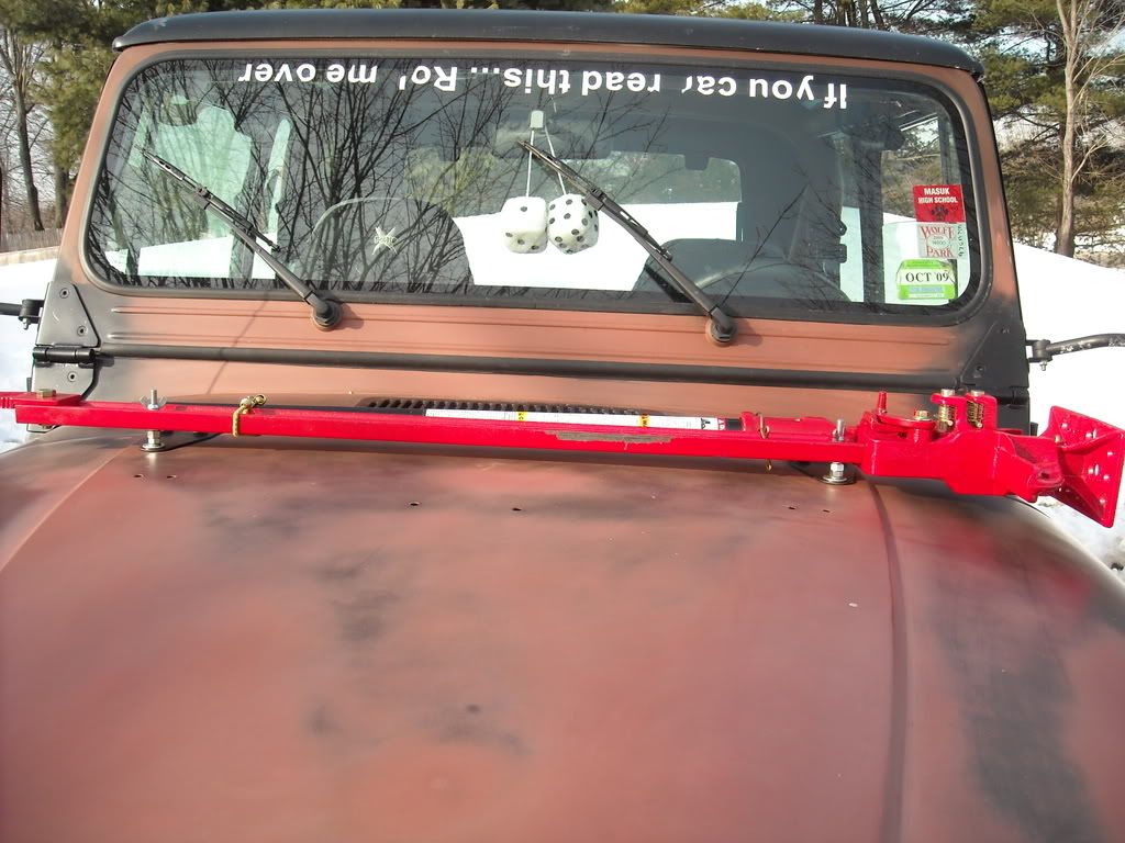

i mounted mine on the hood using two 3 inch bolts and a couple of nuts and washers for spacing. i plan on drilling a hole at the top of one of the bolts so i can slip a padlock through and not worry about theft
