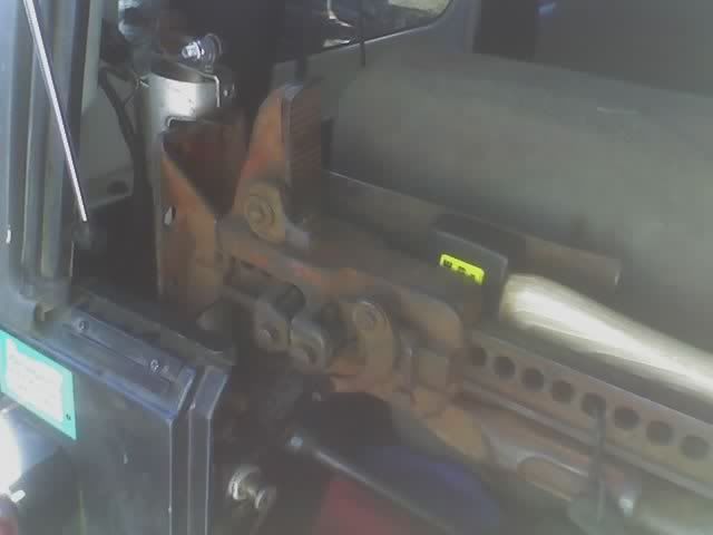

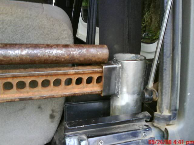

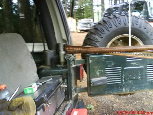

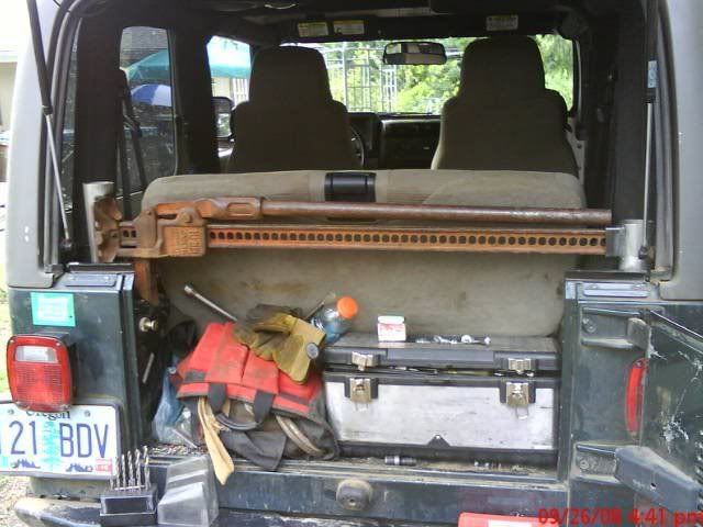

Here's mine... Cut an angled slot in the front down of roll bar and welded a flat shelf with a 3/8 bolt sticking out. Then welded the standard hi-lift security hinge on the back of the roll bar. The base of the jack is resting on a rubber pad on the metal above the tail light. It has worked well so far, secure and quite. Check it out...
