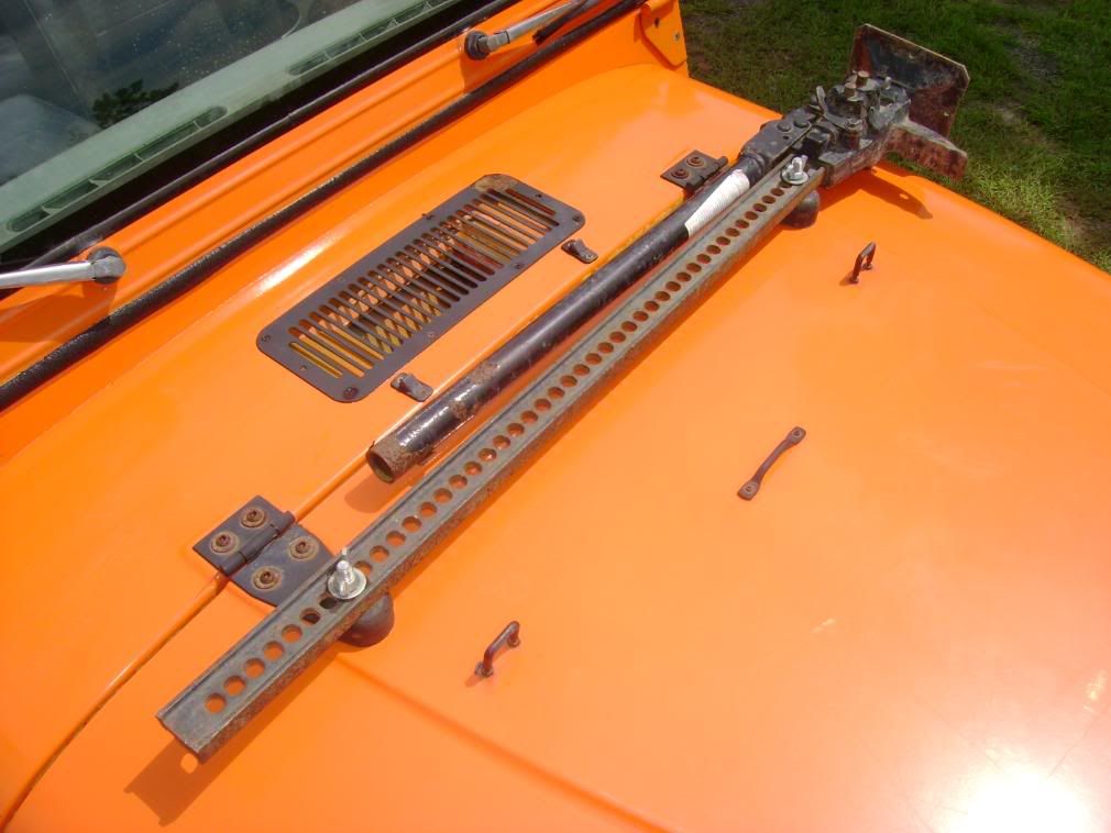

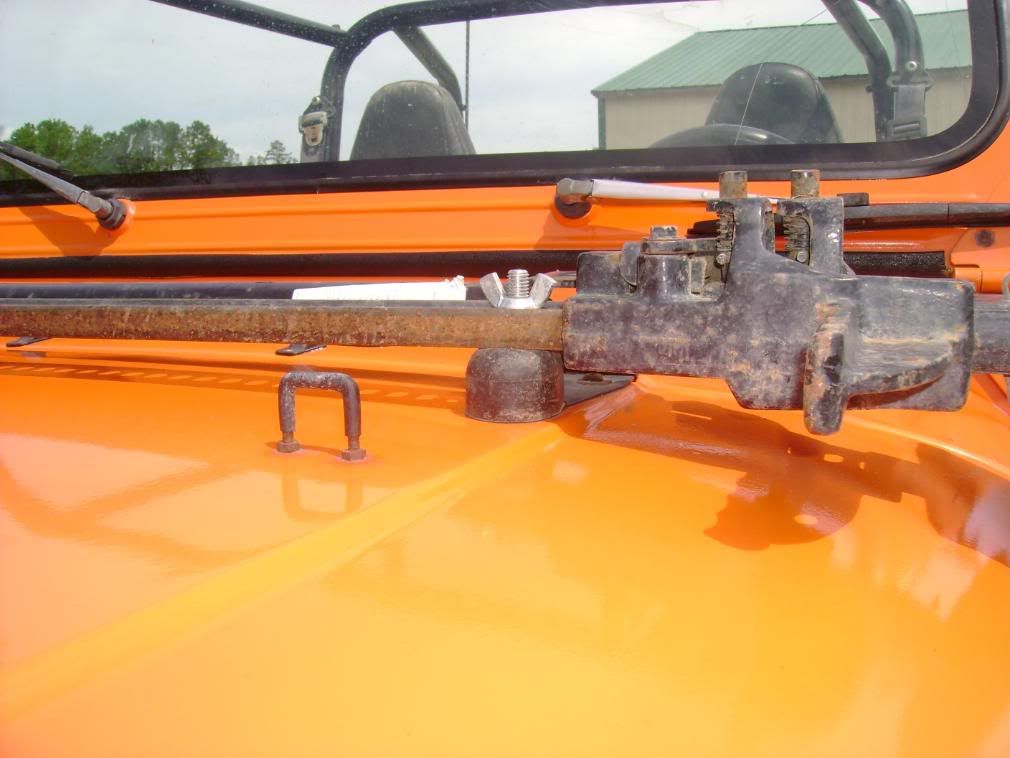

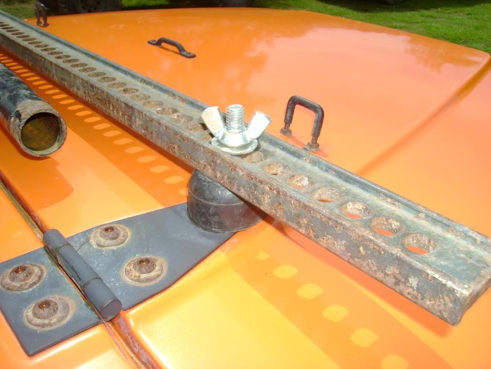

Its been mounted here before, but here is a different way:
Find some tailgate bumpers off of somebodys Jeep they are going to throw away. You will need two.
Take out the bolts and drill the last bolt inserts in the point of the hood hinges just a little bigger than a half inch bolt. Bolt holes will line up perfectly with the jack.
Go buy 2-3.5" x 1/2 bolts, 4 washers, and 2-1/2" wing nuts.
*Hint* There is a small metal washer inside of the rubber bumper, a drill bit will take it right out.
Assemble. The photos below will help. The bolt is a pain to get through the rubber bumper.
This setup WILL NOT RATTLE!!!!!
Just my $.02

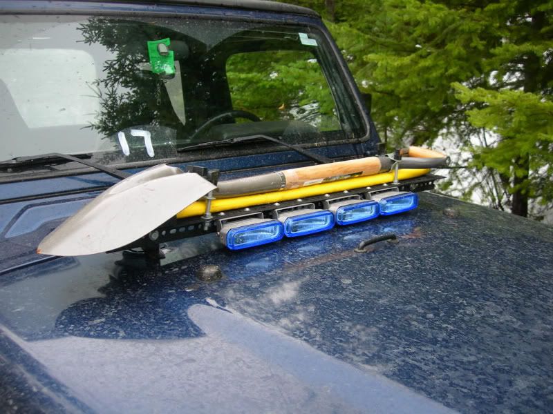

Here is an functioning prototype style pre-runner (esq) light bar/hilift bar.
Had it fab'd locally:

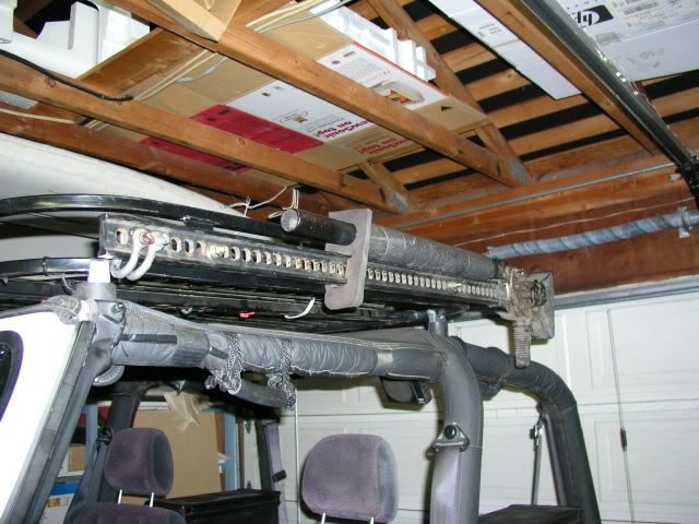

Personally I made a mount that fits behinde the rear seat to keep it inside and out of the weather, and prying eyes. I'll snap a pic of it when I get home from work and post it up
