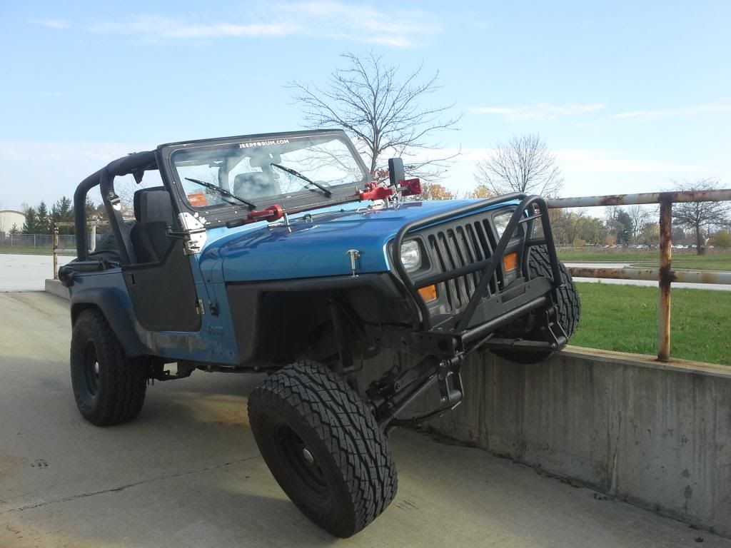

mines the classic hood mount, very glad I have the high lift, has saved me many times.
I didnt pay 40$ for mounts either. Cost 10$ for parts from tractor supply.
2 spark plug sockets
2 6" bolts
2 nutes
2 washers
2 wing nuts
and a lock so it doesn't walk away, keepin the honest people honest!
Bolts went through the front bolts holes in the hinges.
