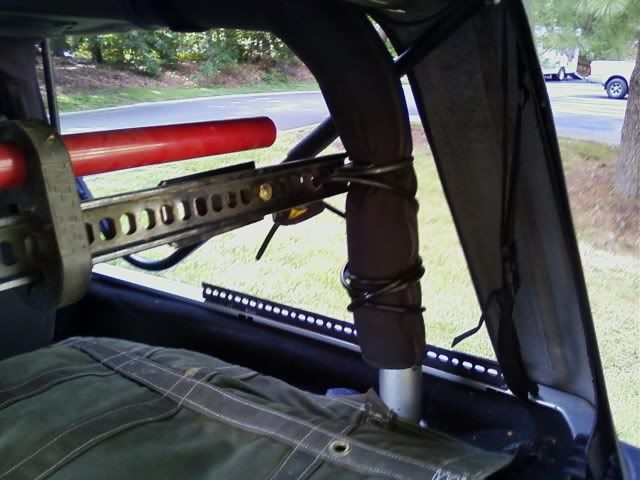

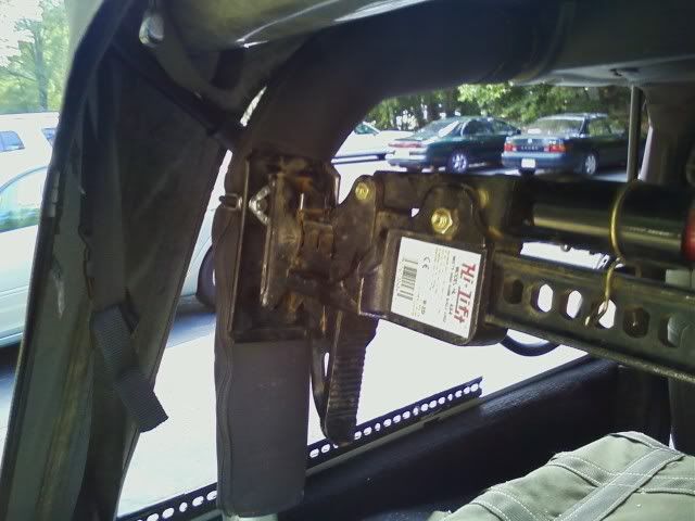

Heres another roll bar mount total cost $7.00 2x mullfler clamps (2.5" size), and 3 wingnuts with washers. I did drill two holes in Hilift, one on base in middle parrel to one already there and one on end of steel lift bar to mount that end. I also added a cable lock color red courtesy of GLOCK here are pics :http://i746.photobucket.com/albums/x...AxNDYuanBn.jpg http://i746.photobucket.com/albums/x...AxNDguanBn.jpg http://i746.photobucket.com/albums/x...AxNDkuanBn.jpg http://i746.photobucket.com/albums/x...AxNTEuanBn.jpg
