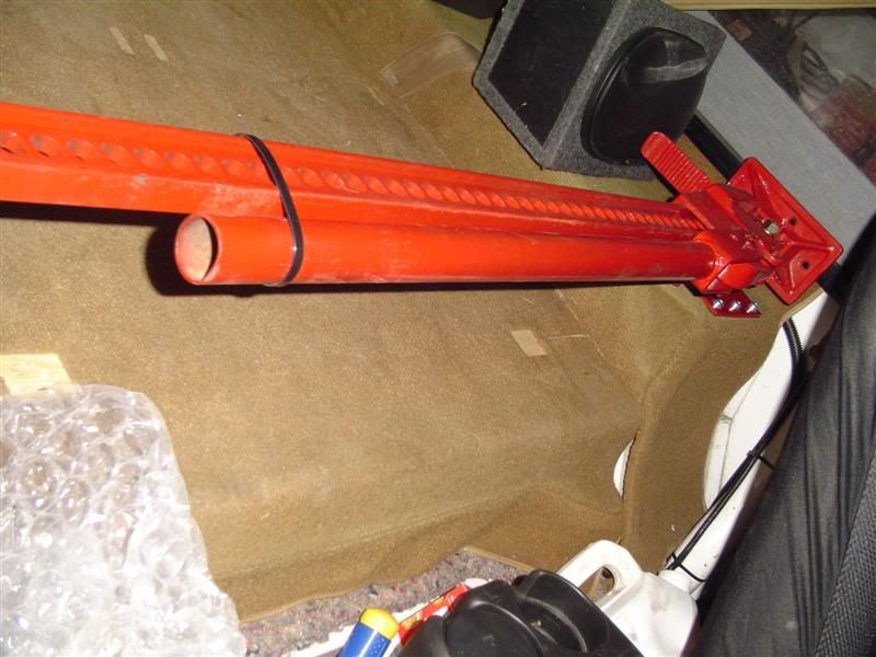

I have just completed a very simple and very inexpensive hi-lift jack mount for inside my TJ. I chose an inside mount to keep the jack clean and safe.
Use a 1/2 thread tap to thread the inside of the hole on the back of the rear roll bars (opposite the seatbelt). Purchase two heavy duty u-bolt plates - not the u-bolts, just the plates (I found mine at a farm supply store, they are about 3 1/2" long with two 1/2" holes - I think they are for a tractor suspension). Bend these plates to about a 45-degree angle (I used a vise and pair of vice grips to bend the plates). Use 1/2 bolts, washers and lock washers to mount the plates to the roll bars. Mount the right one so the plate is perpendicular to the rear of the Jeep (the base plate of the jack will attach here). Mount the left one so it is parallel to the rear of the Jeep (the top of the jack runner will attach here). Use 1/2 bolts, washers and wing nuts to secure the jack to these mounts. Mine is rock solid and safely out of the way. I used all grade-8 hardware (overkill). You may need to experiment with the bends and washers to get everything to line up but mine worked perfectly on the first try.
Here are some photos. I should clarify that I bent the plates 45-degrees from flat. The final angle is about 135-degrees (doesn't have to be perfect). Be sure to find the thickest, strongest plate for a solid mount.

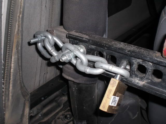

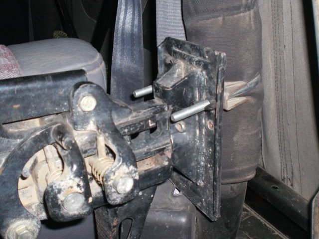

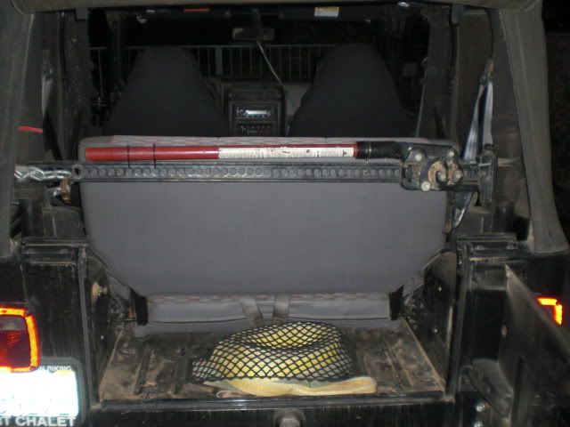

2- 2 1/2 (i think) exhaust hangers (the u-bolts) and 4 wing nuts. put the jack across the back window with the base on either side facing down. there are 2 holes in the base that line up perfectly with the u-bolts. then put the other u-bolt facing towards the back of the jeep and slip it through the holes in the tall jack part. i lock mine on with a short piece of chain and a big padlock. it doesn't make any noise and doesnt get in the way of the backseat, rear window or anything. best mod i have done to my jeep so far
ps... will post pics if requested.
edit: just do it like TJ311
Originally Posted by TJ311 View Post
Mounted inside with 2 2.5inch muffler clamps and 3 wing nuts. Total cost was about $6!

i can get more tomorrow if you want. but you should be able to get the basic idea from these. and yes i have my rear window closed, i just flipped it up for the pics.
