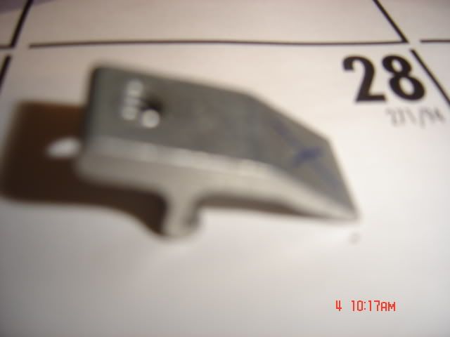

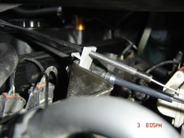

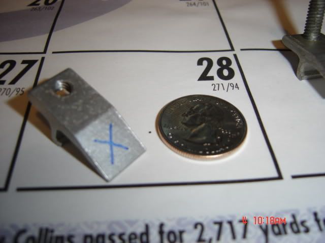

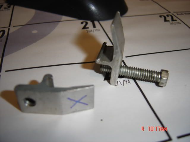

This is the part from my junk draw that worked perfectly. If you know what it is, tell us. I have no clue what this little metal piece is "supposed" to be used for. Whatever it is, it worked. I got a few more I could mail out to somebody if they're interested. Just cover the shipping and one of them is yours.
Any way here's some pics.
First is it installed. I basically cut the cable to lenght then threaded the homemade bracket down the cable until it what right. Then I bolted it in and was done.
That blue "X" is where I drilled a hole just big enough for a nut and bolt I had.
Good luck,
J
Those are old style clips that hold in a screen or window in a storm door....not used much anymore
