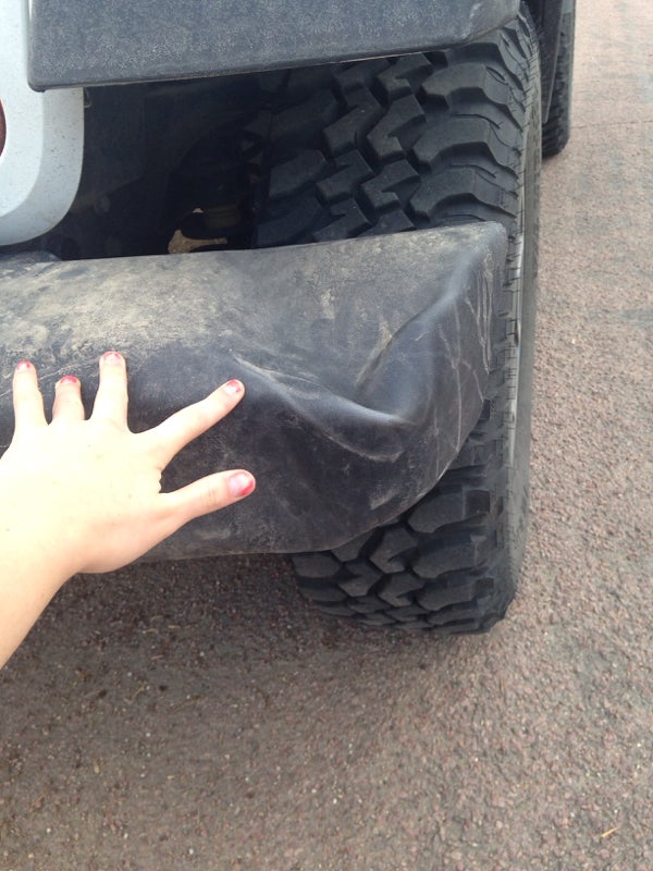

Nicked it while wheeling.... Front bumper took quite a dent... Could I just use a hammer and try to get the dent out? I've heart about using a heat gun, but I don't have one and there's no way I can take the bumper off without my parents noticing something is up.

Seriously though a either way is just going to pop the dent out the damage will still be obvious. You are going to have to own up to it sooner or later. I'd go with the honest road, always less hassle in the end.

It will need to be heated with an electric heat gun and pushed out from the back. It needs to be hot enough to burn your hand so be careful. Next use a rounded item like a broom handle to push out the dent. After the shape comes back cool it off with a wet rag to lock the corrected shape in.Heat guns are 30-40 bucks at Harbor Freight.

Several good options posted above.. But in our case I simply drilled a couple of pilot holes at the back of the dimple.. with a stiff metal rod.. I worked the area back out a section at a time.. Starting at the outer circumference and working inward.. In other words don't try to pop the whole dimple out at once.. work up to it.

it doesn't take much heat. a hair dryer should work.
