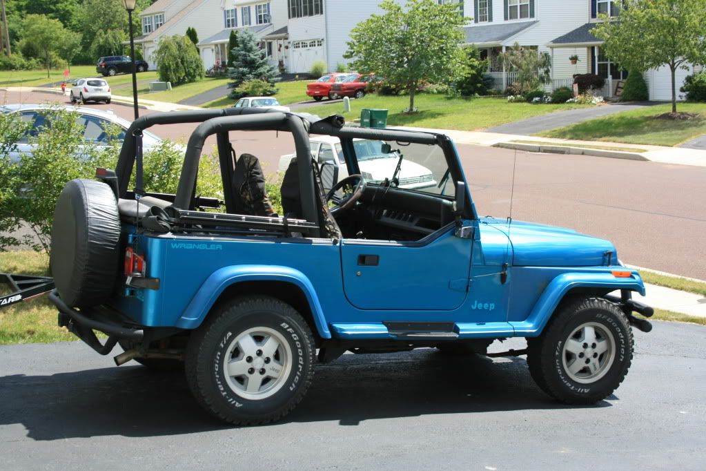

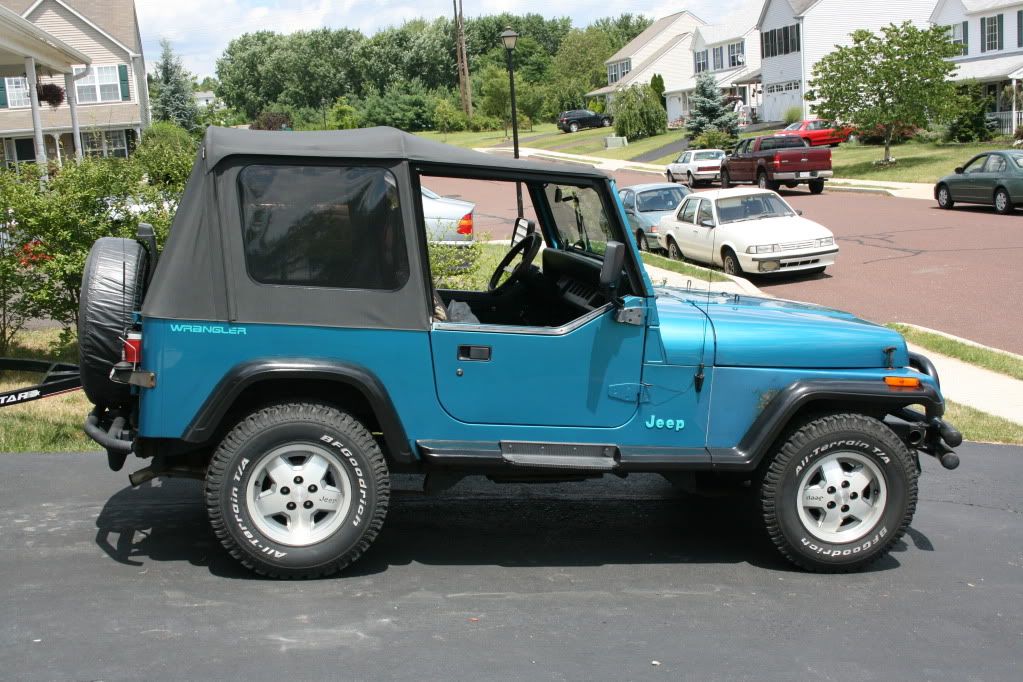

I just did the krylon fusion mod and Im really happy with the way it turned out.
Before
After
