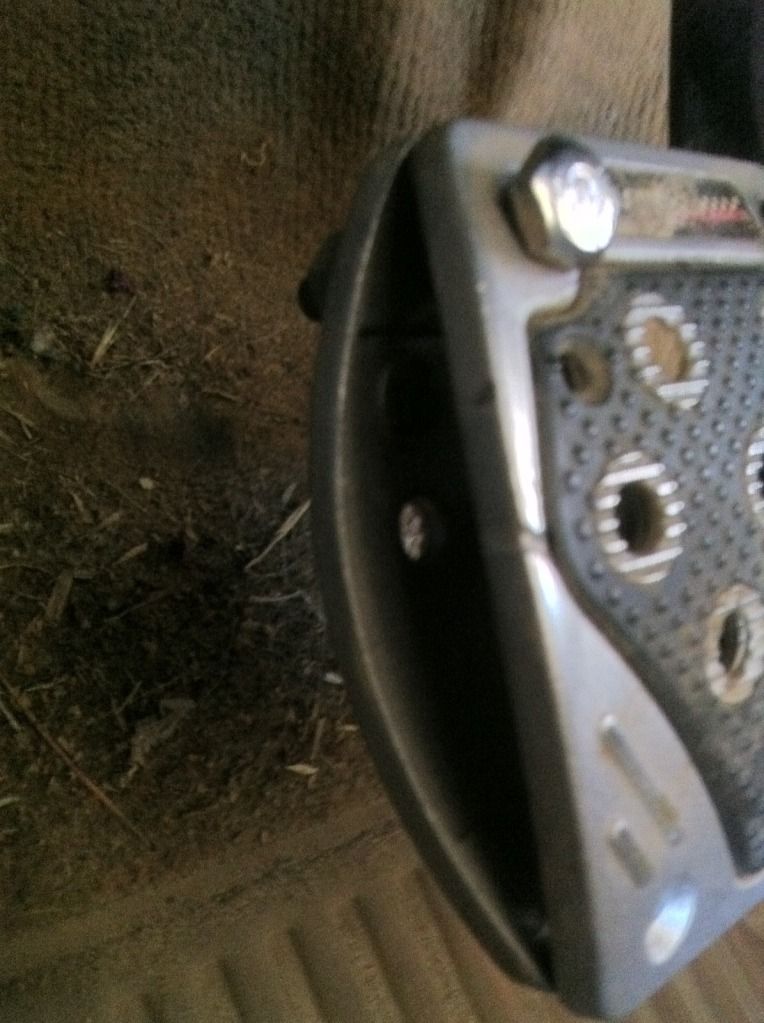

At a bicycle shop you can still get those blocks that go around the pedals of a bike like when you were a kid. It'll attach the same way on a Clutch pedal but only do the top side so the pedal still goes to the floor.

You can do the top and bottom side if you're careful. Just put a small spacer between two pedals with longer bolts than shown and it should hold just fine. I needed something bigger because my left ankle is half titanium and I don't have much control over it. These pedals also give great grip over the stock rubber when its rainy, snowy,muddy or icy outside and it sticks to your shoes.
