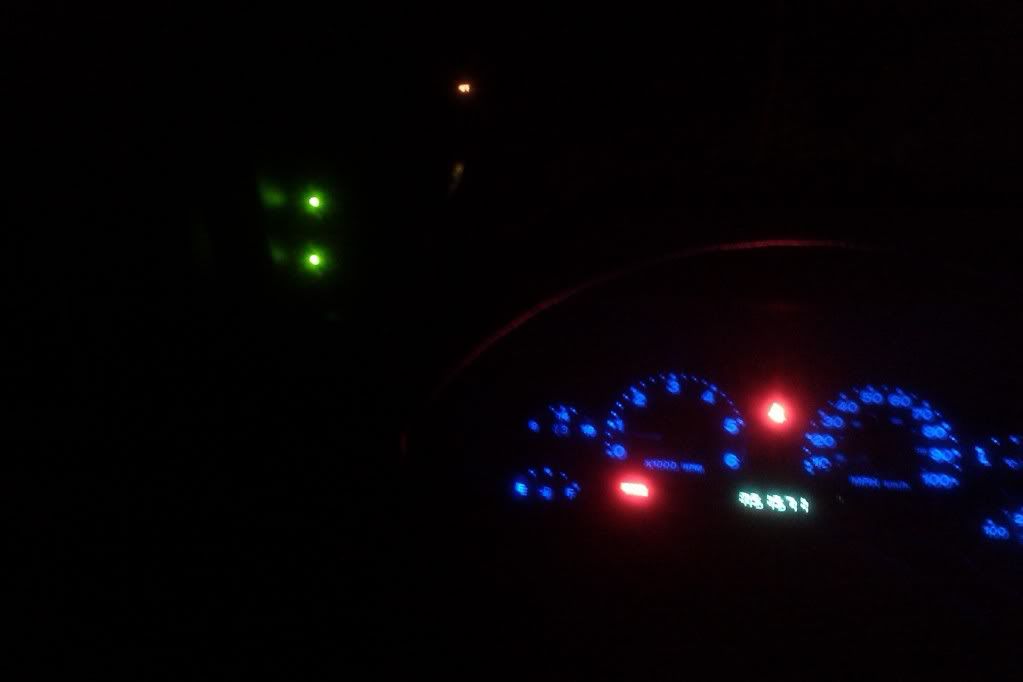

If you can see it enough all my lights are blue. Blue is the brightest. These pictures don't do the lights justice but I highly recommend this mod. Very nice

Can you upload some more pics? I'm thinking about doing this to mine, I just wanna see clearer pics! Awesome idea

The footwell and tub rail lights are on two rocker switches on the windshield pillar (the green leds)
