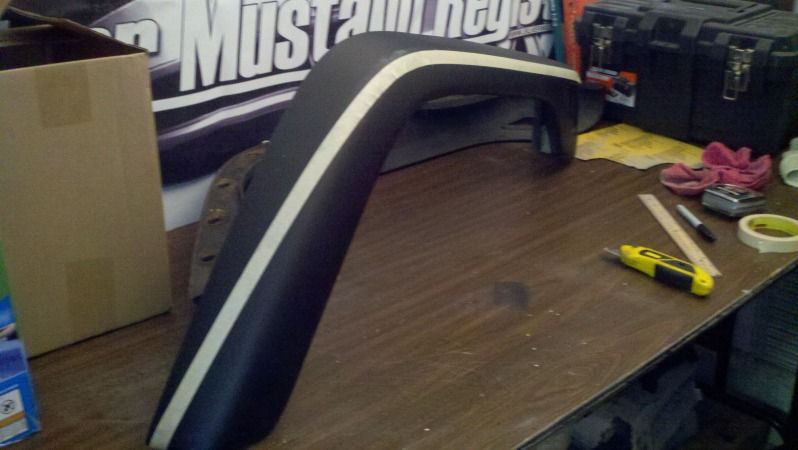

Originally Posted by MustangWrangler View Post
Yeah. I measured 3" out from the edge that goes against the body and marked with a sharpie. Marked with some tape and eye balled the angle going down. I did one pass with the razor blade, took the tape off, did another deeper pass, then did a 3rd pass that cut all the way through.
Brilliant! I wouldnt think it would be that easy. First sign of weather warm enough to take them off, cut and paint them its being done.

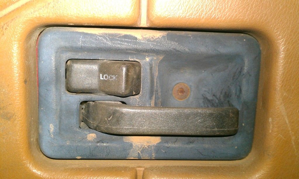

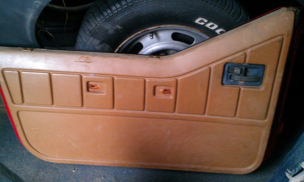

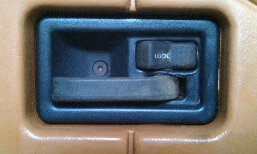

post #1139 of 1365 Old 01-22-2013, 10:05 AM
grandboost98
Location: Essex
Posts: 4,183
Even worked on a set of worn half doors I picked up
You can see where I held it a little too long under the door lock
