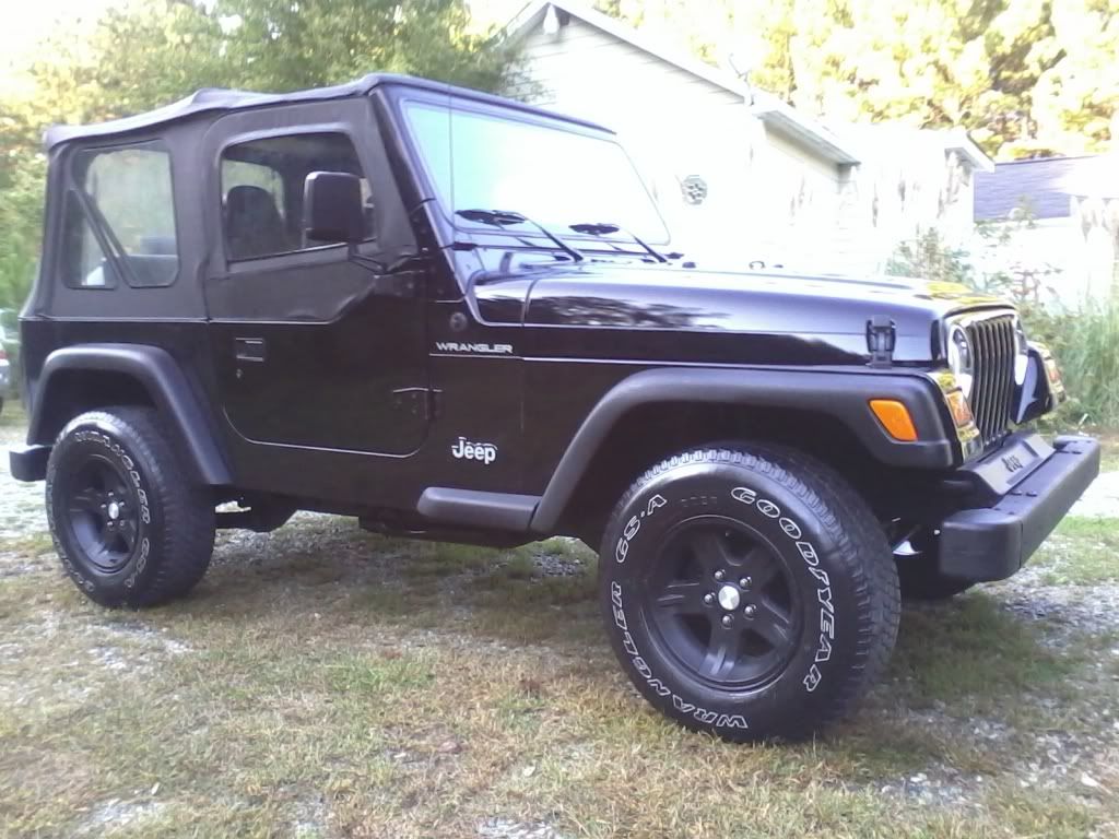

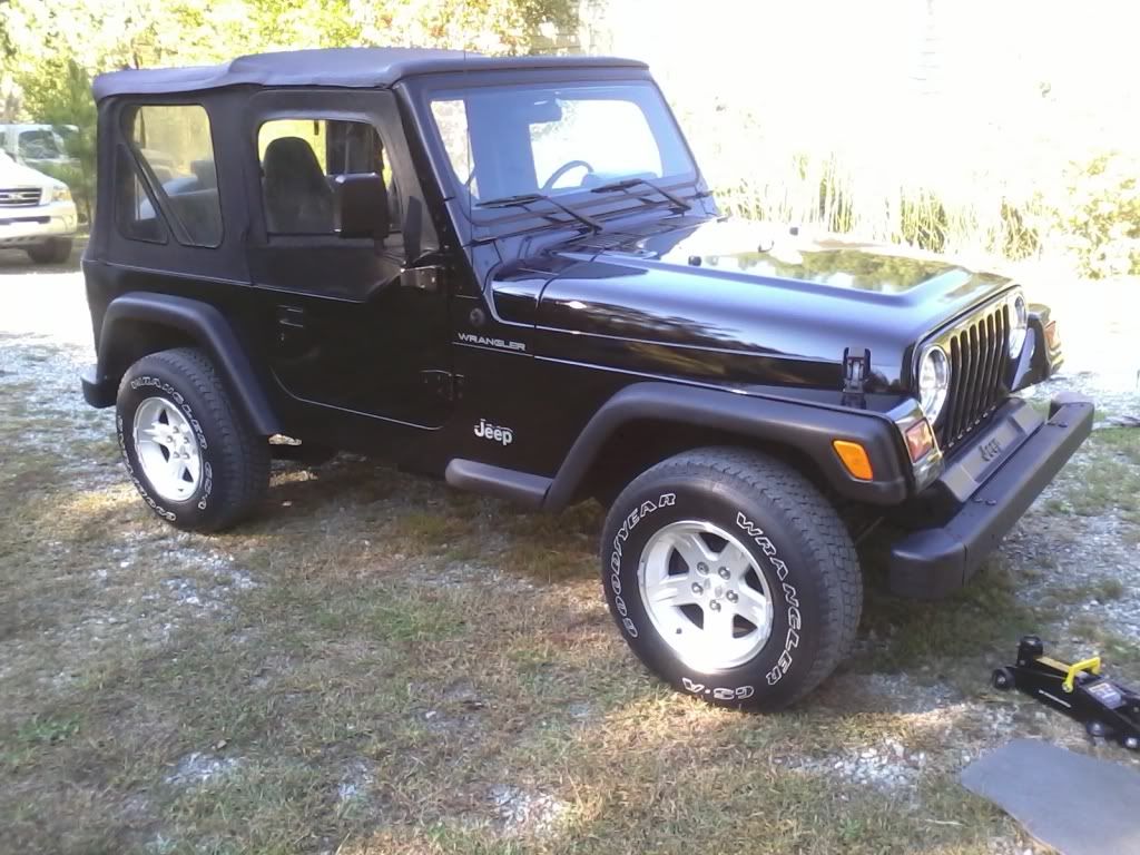

Black rims for $12.00 Bucs
[B]There's alot of YouTube videos on this fix so check them out, The product is PlastiCoat spray. It can be bought at Home Depot, Northern Tool, Lowes ect. This isn't paint but a rubbery plastic coating you spray on and it will make the rims look like they have been bedliner sprayed. Now note it's not the best for off roading because with some effort you can peel this stuff right off which is good if you have chrome or alum. rims and your wanting to switch up. No need for sanding just clean the rims really good with break cleaner, let dry and spray. You don't even need to tape off the tire because after it dry's it will peel off the tire with no issue. Here's mine before and after. Been running now for about a week and everyone thinks they are aftermarket rims. [/B

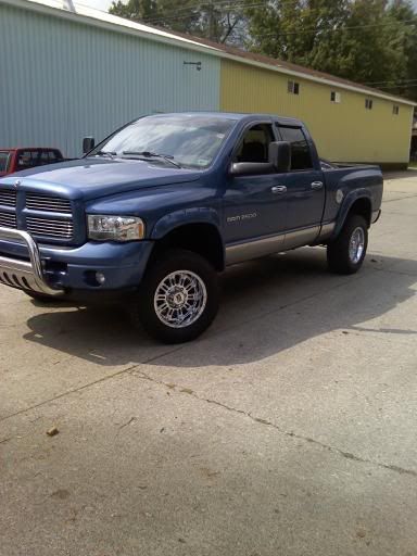

im a chrome man myself and im only 19 lol..i like the lower rocker chromw and nice chrome wheels..i dont go overboard by any means ha just look at my truck
