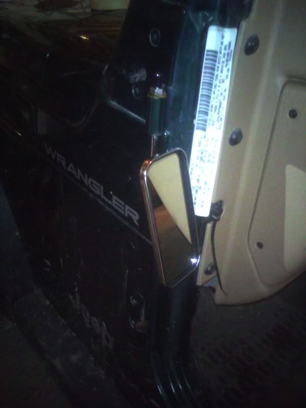

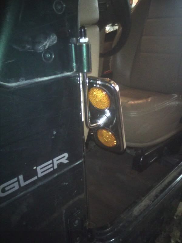

Went to my local bike shop and picked up a mirror for when I have the doors off. The threads aren't long enough to be a simple bolt on, so I improvised. I took masking tape to make up for the play within the door hinge, flipped the mirror upside down and threaded the bolt on top. I have yet to test drive it, but in the garage, it covers my blind spot. Not bad for $7.
oh and in the first photo, you can see my cheap dome light mod. Just a zip tie real tight and it holds the switch in place, its reusable too, all you have to do is push the zip tie forward and it releases the switch for when you go door on.
Run a nut up the threads all the way, then weld a longer threaded shaft on the end of the present threads (cut another bolt). Plug it in right side up, then spin up a nylock nut on the bottom new threads.

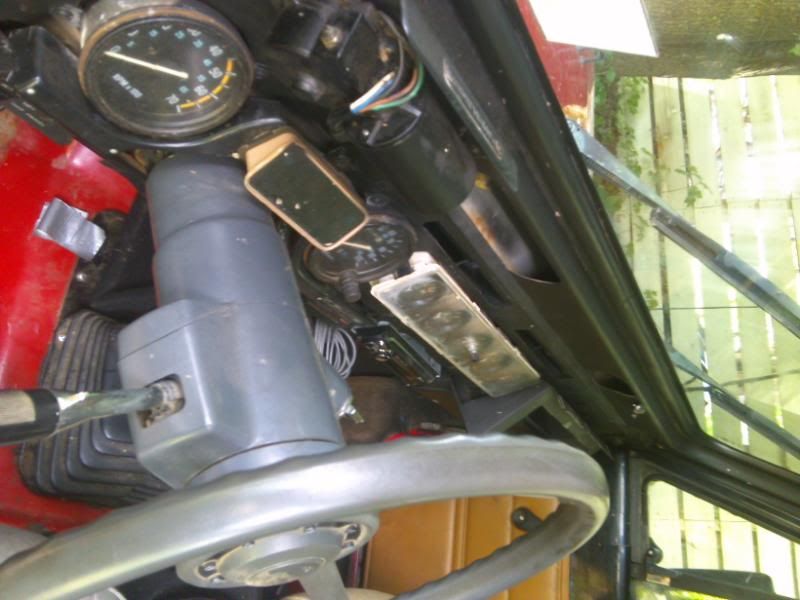

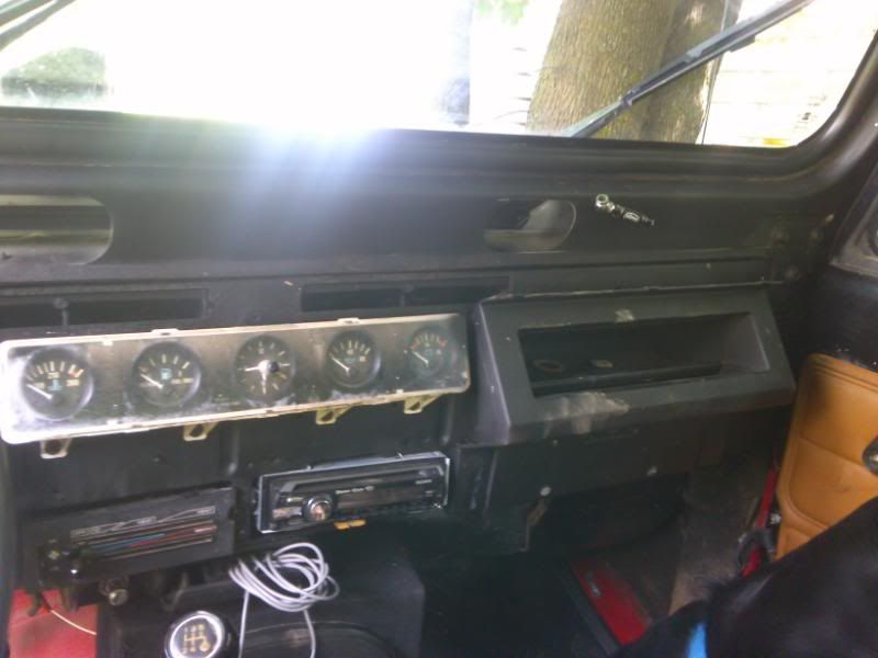

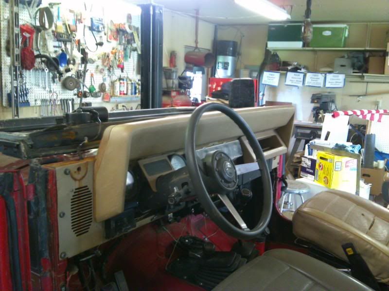

i own a 1990 yj i removed the dash completely. im my view looks 100 times better
post up a pic, i'm curious to see what that looks like!

lets see if i can get this to work.. never put up pics before
before
<a href="http://s283.photobucket.com/albums/kk306/romanos93/?action=view&amp;current=IMG_0234.jpg" target="_blank"><img src="http://i283.photobucket.com/albums/kk306/romanos93/IMG_0234.jpg" border="0" alt="Photobucket"></a>
after
<a href="http://s283.photobucket.com/albums/kk306/romanos93/?action=view&amp;current=IMG_0363.jpg" target="_blank"><img src="http://i283.photobucket.com/albums/kk306/romanos93/IMG_0363.jpg" border="0" alt="Photobucket"></a>
<a href="http://s283.photobucket.com/albums/kk306/romanos93/?action=view&amp;current=IMG_0364.jpg" target="_blank"><img src="http://i283.photobucket.com/albums/kk306/romanos93/IMG_0364.jpg" border="0" alt="Photobucket"></a>
