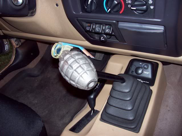

did this quite a while back... drill and taped a hole in the side and used a 5/8x2 1/2 bolt as a sleave...cut the head off the bolt and drilled and tapped the bolt to fit the stock shifter threads. the grenades are hollow so the sleave was used to make it stronger. mixed up some jb weld and used a injector to get it into the bottom hole of the gernade to make sure the sleave would not get loose. waited for it to dry up over night and put it on the jeep. I did use a very clear epoxy to sucure the spoon /pin and ring. the epoxy is not noticeable and the spoon and pin will not move . I have resently removed it and painted the spoon and neck so looks like a live grenade and not the """"hey look at me im a dummy grenade"""". ..
these pics where when i first mounted it ..look better since painted.
