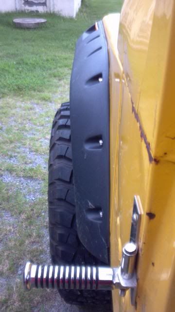

Not the best pic but I used an old peg from a Harley that was given to me. Cut a piece of aluminum angle to go between peg and the body. Then some felt between the angle and the body and put a bolt through it.
Also made some for my cousins '7 pretty much the same but used a piece of square tubing to extend it closer to the bottom of the tub. Welded a nut on each end of the tubing. Bolted peg to one end and the other end to the door hinge.
Those look noce
