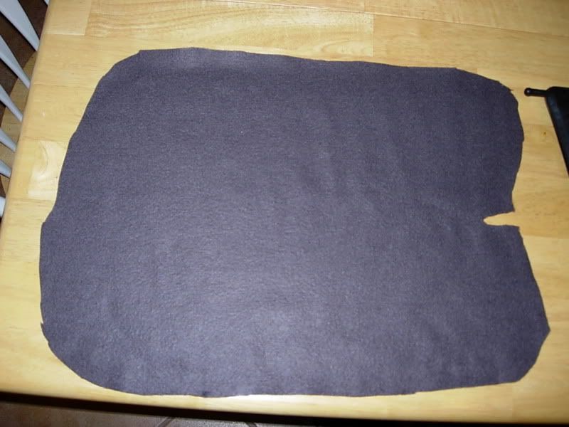

You have to take into account the folds in the old fabric otherwise you wont have enough material to fold around the edges of the visor.
You have to cut a slit for the mirror and the wires too. Take your time and figure out the best place for it.
Once I got everything in place I started at one side and worked my way down. Lay a small stretch of glue down and fold the material over. I actually used hot glue for this part only because it dries faster than the other glue. Almost instantly. Also since the visor folds in half and clips together there is no worry about the glue melting and the material falling down in the heat. DO NOT USE HOT GLUE FOR THE HEADLINER!
When once side of the visor is done and dry, flip it and do the other side. You want to pull the fabric tight and glue it down so you don't get any weird folds and creases. Just take your time and plan ahead as you stretch and glue. You'll see some folds start appearing around the edges of the mirror. Just find the opposite side, pull the material tight and glue it.
