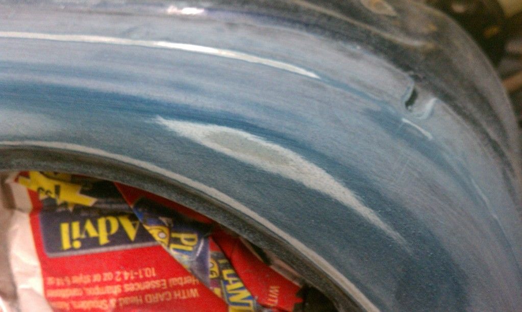

I covered up the headlights, did a small amount of masking, and went at it with an entire sheet of 180 grit.
It really shocked me how thin the factory paint and primer really were, and how quickly I made it down to bare metal.
I then windexed the grill to get the bulk of the powder off. Then I used rubbing alcohol to clean it all, until I stopped getting powder blue off. Then, apply newspaper!
