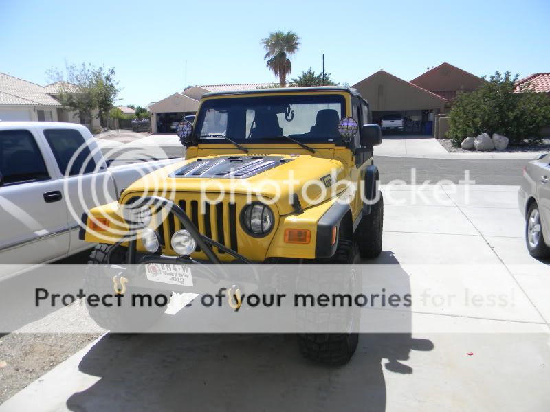

Ok same problem. Here's the pic:
and a previously requested under the hood shot
