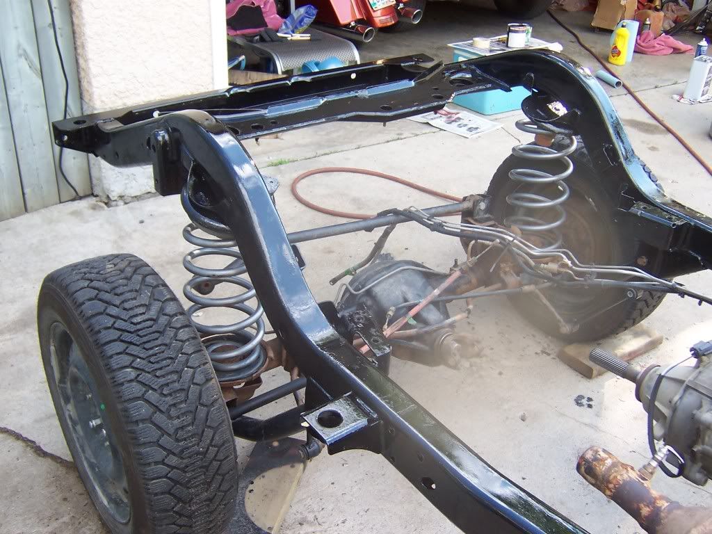

Did the first coat of Chassis Saver on my frame yesterday, took almost a full afternoon to brush the 1 coat. I found in some areas if I slightly thinned it I could get it to creep into the little areas..
Here are a few pics:
Before:
After:
Before:
After:
I was extremely happy so far with both the ease of application and the coating itself, the plan is to do another coat and then a few coats of Tremclad Professional for the parts exposed to sun..

Nice, I always like to thin CS even when brushing. Just makes it flow a little better and easier to spread
