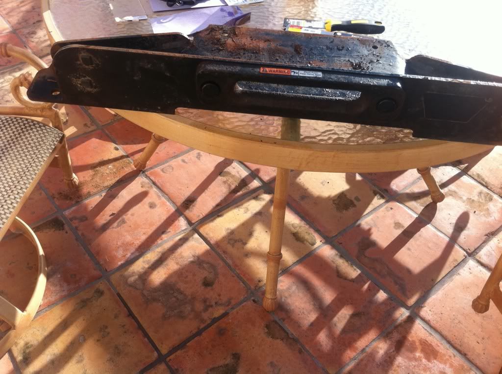

Alright, I got a used Warn winch plate. It was pretty rusty so I spent half the day chipping off all the loose rust and anywhere the paint could come especially around areas of rust to make sure it didnt spread underneath the areas the were still painted. If I coat this in CHASSIS SAVER will I need to remove the rest of the paint? should I only coat the rusty areas and try to avoid the paint, or is it safe to scuff up the paint and chassis saver right over the whole thing?

I just did the same to a pair of M416 trailers, frames, fenders, etc. Removed all the loose stuff then scuffed if you will with the grinder and flapper or black fiberous pad thing. Had bare metal in places, rust in places and paint in places. Coated over everything with Chassis Saver and it seemed to work great. Did two solid coats over everything and it looked GREAT when done. Much better than expected. I figured if it didn't come off with the grinder easily or without too much trouble, then it wasn't worth messing with and the chassis saver would take care of the rest. Once coated with Monsta over that, can't even tell-looks great overall.

willystruck is right, just paint it all. Technically, Chassis Saver is only as strong as it's bond to the surface beneath but if the remaining existing paint is sound you should be fine just to coat. If there was some rust starting under existing paint it could bleed through in small spots in the future but you can touch it up then.
Only other way here would be to blast it all clean before CS

I decided that it would only take me a few more hours to grind it all down with my dremel and a few grinding stones, so I'm leaving it how it is for now and when I have the chassis saver in my hand (ordering when my mother gets home, she wants to buy it for my birthday) then I'll go ahead and finish grinding it down, prepe the inside of my jeep for the monstaliner and prep my CJ7 tailgate and then crack open the chassis saver and try to tackle all the projects at once!

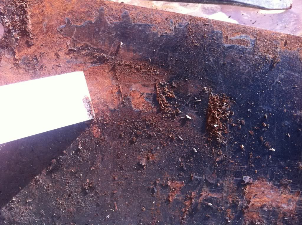

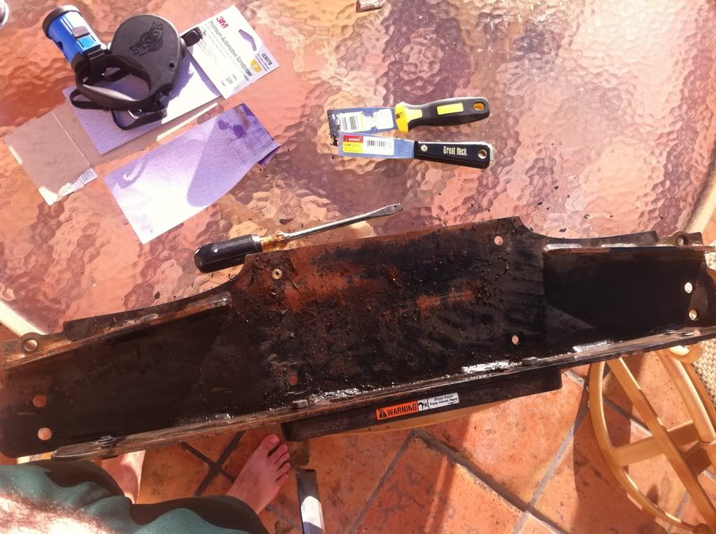

Alright, here's where I started on the winch plate... stuff is nasty, shortly after this picture was taken I took out the grinding wheel and flap wheel and had at it and right now everywhere the paint was loose bubbling or within 1/4 in of rust has been taken down to bare metal will post more pics after its chassis savered tmw or friday
