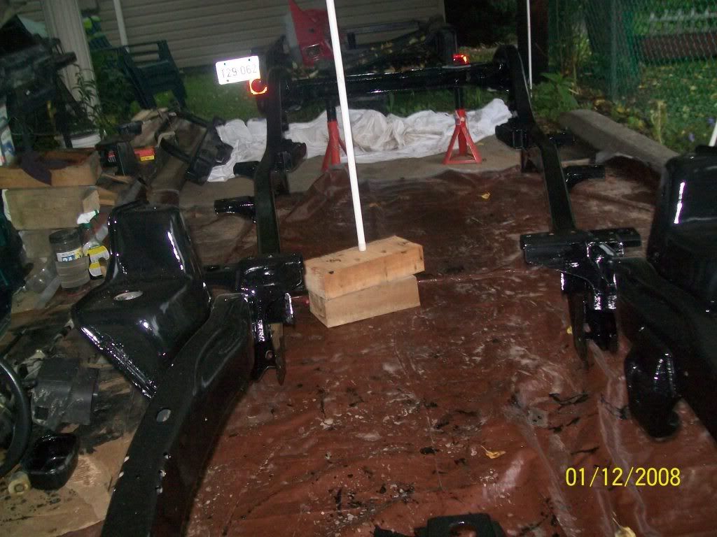

Yeah I gave up one putting CS on the inside of my frame how did you get the sponges into the frame? there is a crossmember on both ends of the frame???
Anyway a pic or two...
Before:
After:
I was gonna do the axle housings with CS too, but i dont think the stock skid(AKA shovel),D35 or LP D30 will be under my "new" Tj for long.....come on tax season!!
I do have one more question: Can you put Bondo over top of the Gloss Black CS? Will it stick to it if I sand the CS? Or shoud I Bondo first then CS over the Bondo?
Building my junk with more junk, so Im always on the look out for more junk....Free to cheap preferably. :D
