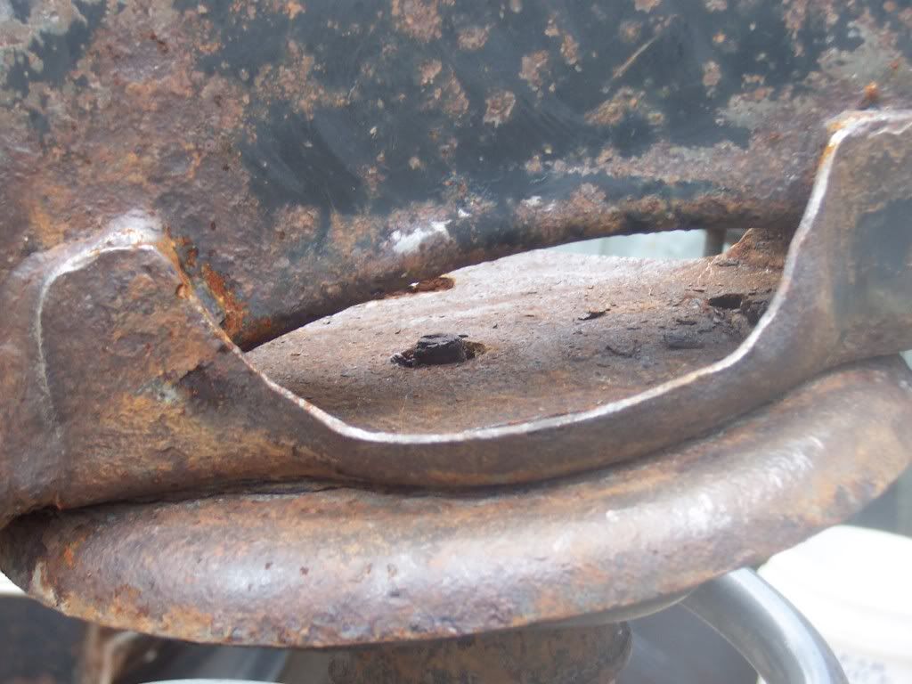

Are you able to just paint right over the rust right?
Obviously after just knocking off the heavy loose but leaving the rest? does it convert it?
What i plan on doing is wire brushing most of the rust i might have painting it with the Chassis saver including axles and spring perches,
undercoat the jeep with the Chassis saver.
Problem is i already have some 3m undercoating spray on there should i try and get that off? or clean it super well and paint over it.
i found this one time pulling up my carpet dry it out damn rain. so trying to be as proactive as possible

wire wheel that rust to get all the bulk off then hit the entire area that you wire wheeled with 50 grit sandpaper and make it really good and rough, then paint chassis saver over it and you will be happy.
You dont want to just wire wheel because it actually plishes the steel and hurts adhesion.

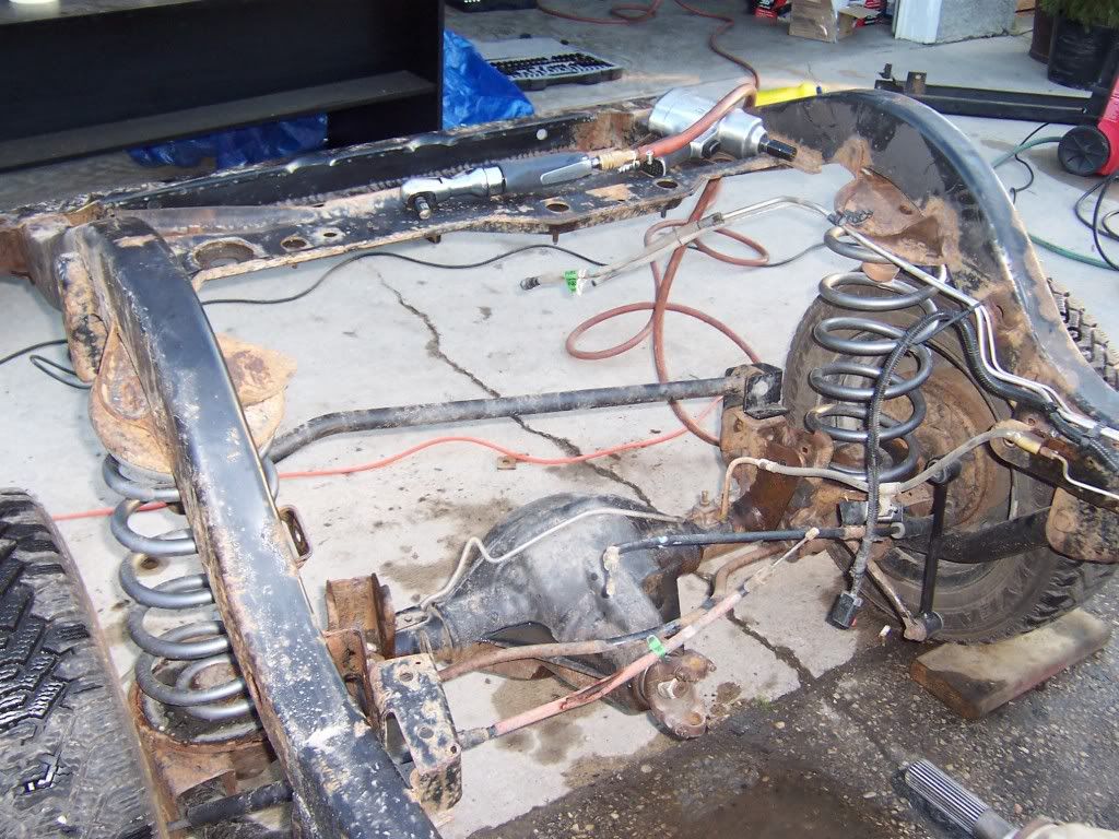

How much CS do you estimate it took to do 2 coats on this whole frame?
Originally Posted by 2000GrayTJ View Post
Did the first coat of Chassis Saver on my frame yesterday, took almost a full afternoon to brush the 1 coat. I found in some areas if I slightly thinned it I could get it to creep into the little areas..
Here are a few pics:
Before:
After:
Before:
After:
I was extremely happy so far with both the ease of application and the coating itself, the plan is to do another coat and then a few coats of Tremclad Professional for the parts exposed to sun..

probably around 3/4's of a quart. I brushed the first coat and sprayed the second, a little paint seemed to go a very long way . When I bought it, the sales guy said I would need 2 I'm glad I got the second one though..
great product so far, in total I have 2 coats of CS and 1 topcoat
