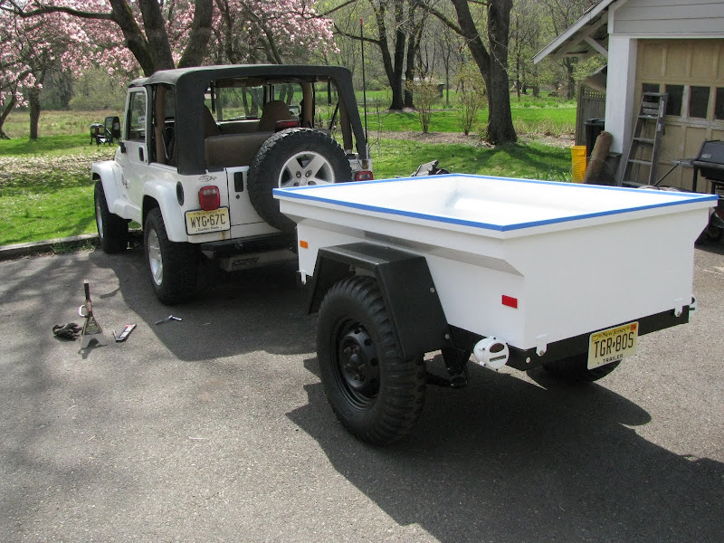

I just ordered a gallon of Monstaliner for my M416 Trailer. Unfortunately I herculined the inside of the jeep last summer before I knew about this product.
The Inside of the bed is currently coated in rustoleum primer. What is the best way to prep the surface for the Monstaliner to ensure proper adhesion?
Here is a pic of said trailer
Indy is my new BFF!
Is that spray can Rustoleum primer or liquid from a regular paint can?
