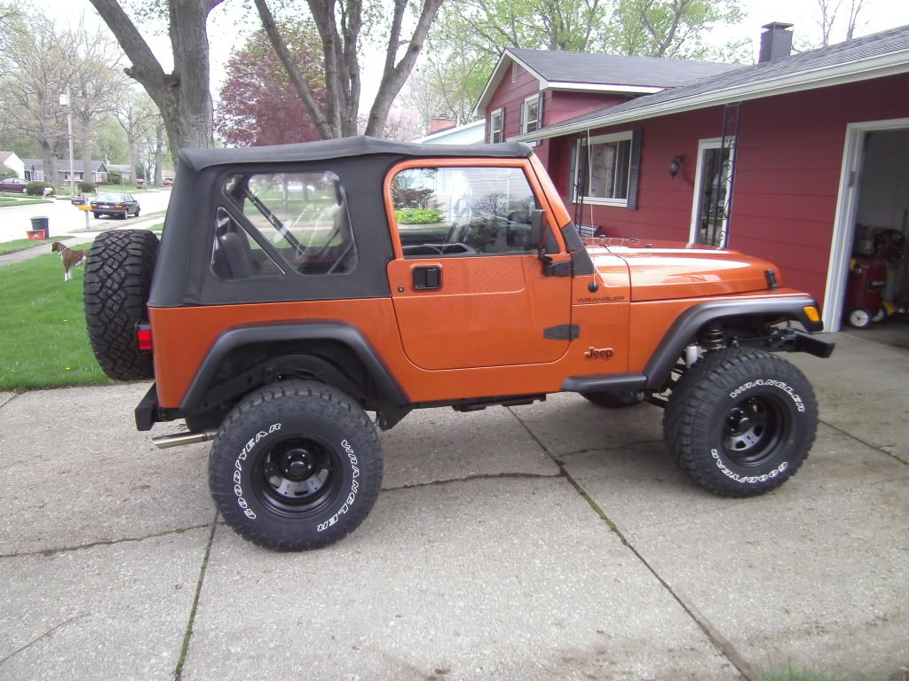

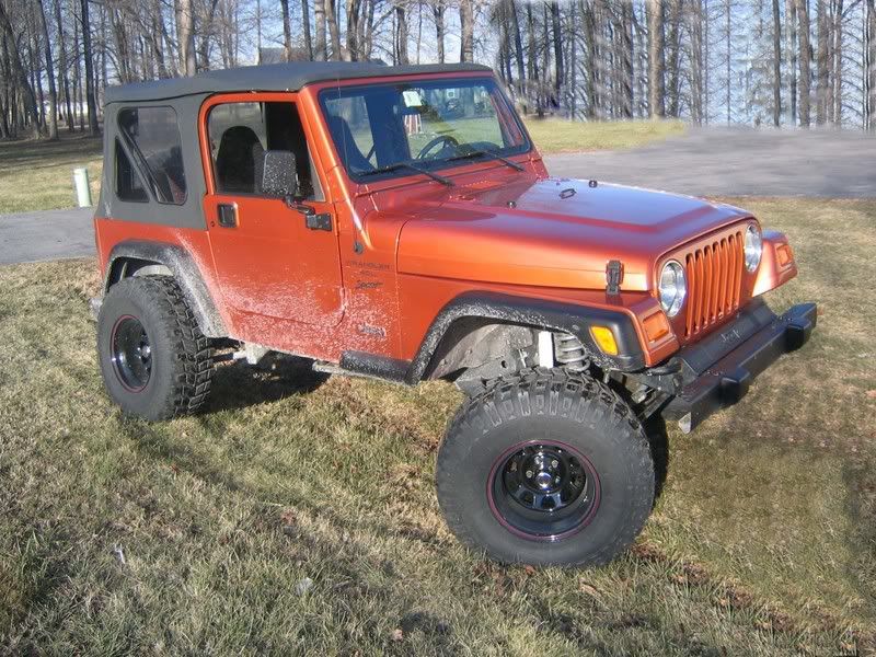

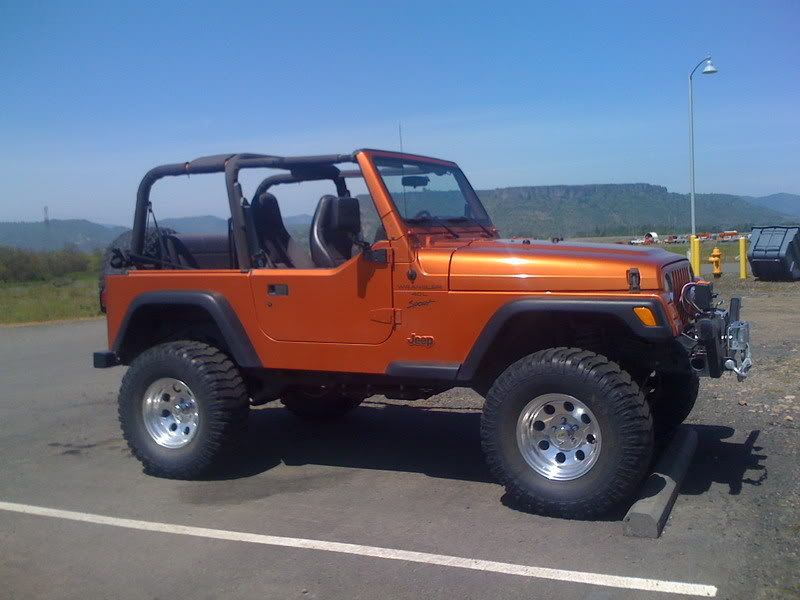

2 choices, Dark Burnt Orange ML or buy custom auto tints.
Have you compared a DBTO chip right next to your current paint?
Originally Posted by Screach View Post
@magnetman
Hey Eric, I have recently decided to pull the trigger on monstalining both the tub and the exterior of my '98 TJ. I have always wanted to do a burnt orange scheme. Could you give me some suggestions as to how I would best reach the color in the photos below, while using Monstaliner? Thanks!

Sounds good, I have paint samples on order right now for you guys, my current paint is hunter green so the orange will be a completely new color.
