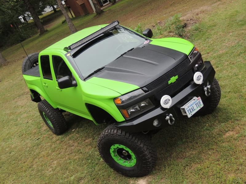

Ill just leave this here man I love this color !
