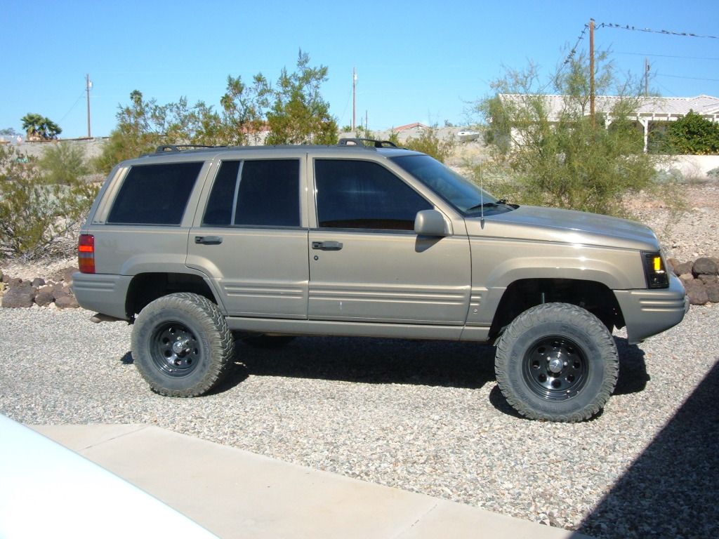

Im going to be doing my ZJ soon I think full exterior Monstalining. Im stuck between white smurfadelic and predator so I ordered some sample chips.
I read from a fellow ZJ member he did 2 gallons for his ZJ in desert sand color and a quart of black on his bumpers and cladding but said he would do 3 gallons of color rather than 2 if he did it over again so I guess I should probably get 3 gallons.
If I do white do I need to do the universal white primer first to get good coverage like I would with the predator?
My factory paint color is chargold. Paint doesnt look that bad at all in pics but there are some rust issues here and there that need to be taken care of and tons of chips and scratches everywhere on it so I think its time to take care of the rust and Monstaliner her.

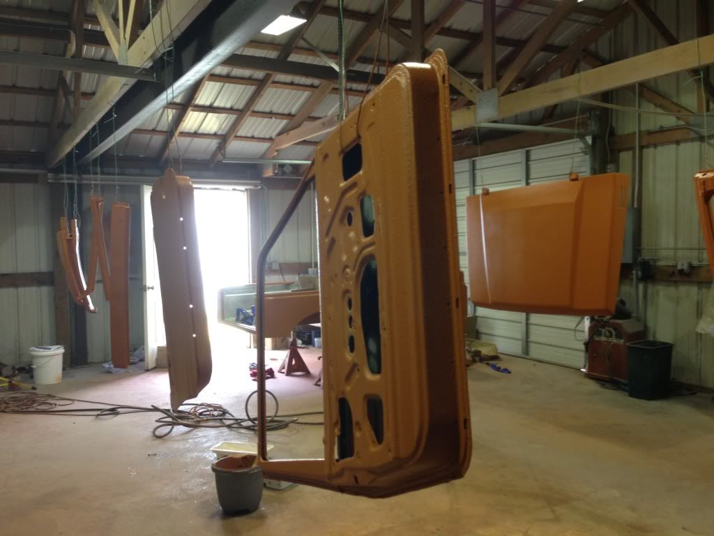

Got everything sprayed with two coats. This stuff can get very messy and starts to thicken up very quickly. Had to add acetone periodically. 4 ounces doesn't really cut it right off the bad per instructions for spraying. Other than that so far the product looks good!
Lighting kinda sucks on the last two. Sorry

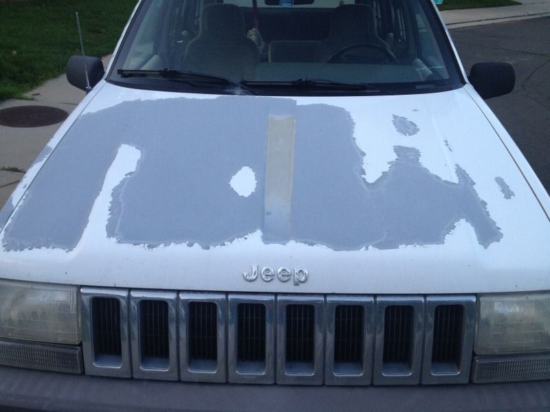

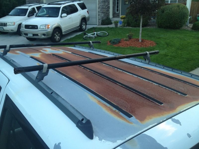

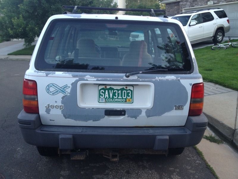

Product Ordering Help Needed
Hi Eric... I'm about to order Monstaliner for my ZJ below and wanted to get your input on all the materials I'll need. I'm planning to do white on the body and black (or grey) on the bumpers, cladding, roof rails, rock sliders, and trailer hitch. Can you please give me your input on the following questions:
  • What grit sandpaper should I use to remove the paint, primer, and rust? I have a Porter Cable (7424xp) random orbital sander/polisher which we'll be using to do the sanding. I don't have enough air for a DA.
  • After we sand the Jeep... which of your sealer/primers should we use and how much? We plan to roll it on.
  • Do we need to seal the rust some how... what product do we use and how much? I've used POR15 before on my vintage VW's. Do I need to sand this before applying the primer?
  • Is there a period of time which the sealer/primer needs to dry?
  • What prep do I need to do on the plastic pieces (bumpers & cladding)?
  • How many gallons of the white will I need?
  • How many gallons of the black (or gray) will I need?
  • We plan to do a panel or two at a time to prevent being overwhelmed. Do we just pour what we need into a container and then seal the can back up?
  • We also plan to remove as many pieces from the Jeep as we can in order to get a more professional look (door handles, trim, bumpers, cladding, license surround, etc.)
  • Any other tips as we start this project?
Here are the as is pictures...

Is this all you need to know?
To sand to bare metal use 60 grit and it will go fast. Take that roof down to metal and get rid of the rust
Prime all with 2K epoxy primer. It rolls nicely, get white hot dog rollers at HD or Lowes
Recoat the primer within 2 days or you need to scuff it. You can ML over the primer in 3 hours
Not sure on your ML requirements. May do it with 1 gal ea WHT + BLK/GRAY. Do some measurements. Coverage = 60 sq ft from 1 gal. Can't use tomorrow what you mixed with catalyst today. Do WHT 1 day, BLK or Gray next day
See here for plastic prep
http://www.monstaliner.com/documents...ng_Plastic.pdf
Tips: Have a good helper, good lighting, no beers, women make the best supervisors for jobs like this (I'm not kidding)
No White Castles, eat fruit only or salad with lemon juice and balsamic
Edit: I don't think 1 gal of white will be enough. Do the measurements and let me know what you have

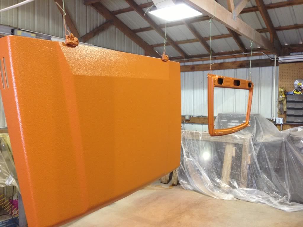

This is properly scuffed paint for ML (before solvent wiping)
Back door has not been scuffed yet
I have no idea what kind of scuffing job that thingamajig you got will do
Rusto primer should be dry to touch. Check the directions what they say

2 good coats of white will cover that without primer but the primer will make your job easier and you could avoid a 3rd gallon for sure
