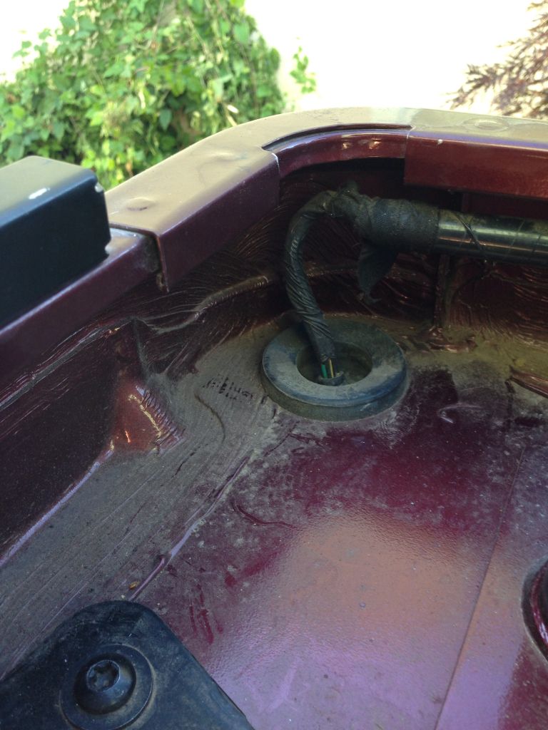

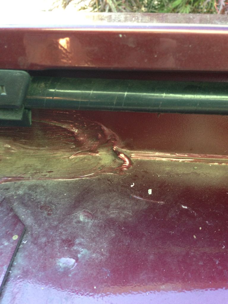

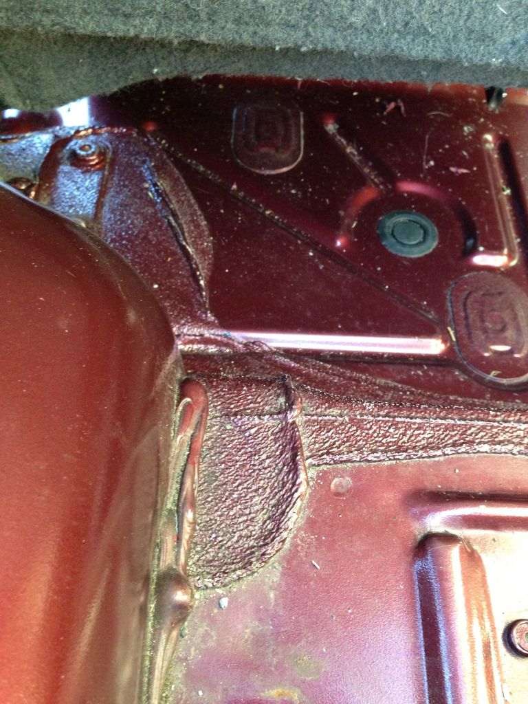

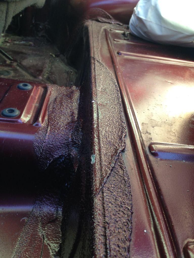

Help please. I am hoping this is a stupid question but I am getting ready to do my tub on the 03 TJ. I had asked about reparation some time ago because of the amount of horrid factory work under he carpets. So here are some pictures. This stuff is soft to he touch. Do I sand it off! Razor trim it first? I want my job to look good and am worried hat the liner won't cover up this much crap.
Thanks for opinions!

If you have a die grinder, use that with a 3" red scotchbrite disc. Get a lot of disc because they will load up as you take that crap off. You don't have to go down to bare metal, just smooth it out some.
Chrysler never thought that we would not want carpet in, so they let the assemblers get away with doing that type of work.

I wonder if you heated this stuff with a heat gun or torch if you could just take a long sharp kitchen knife and slice off the high spot and ridges then heat it some more and gently hammer it flatter
[/QUOTE]
Had not thought of that. I will test out with my heat gun. Might even just flatten. I will update progress in another thread. Don't want to bog this one but will post final here.
