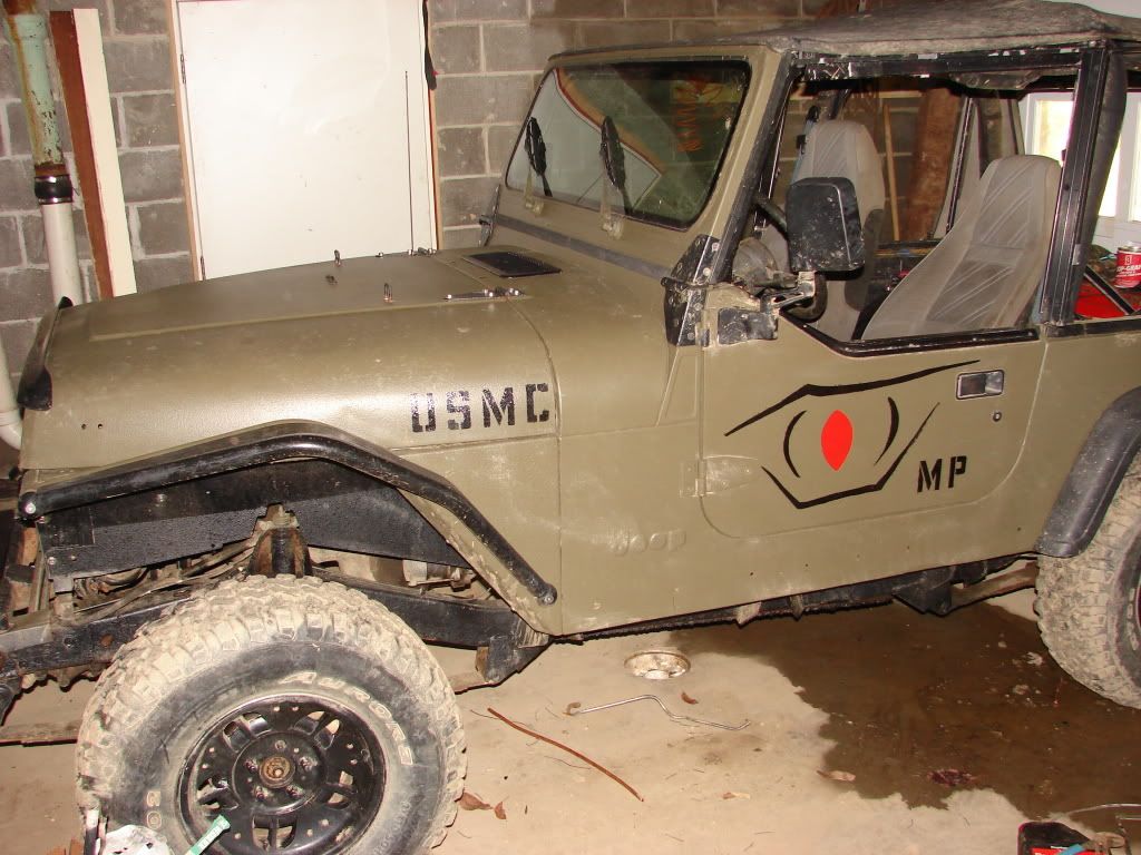

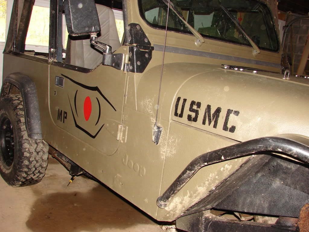

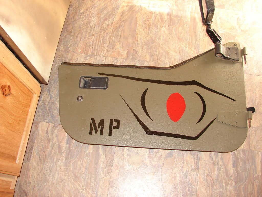

post #10698 of 13509 Old 06-27-2013, 10:10 AM
mike_breaker_5
Location: emporium,
Posts: 3,009
yup... here
Originally Posted by mike_breaker_5 View Post
yesterday i ran new fuel lines and wrapped them in header wrap. hopefully that will keep the fuel from getting a vapor lock.
finished up the stencils today.
pics are pretty self explanatory.
Ratmonkey donation page. all proceeds will go to his family.
it's not much to look at... but it's mine.
5.2lswap, metalcloaks, bedliner, tucked belly, d60's, soon to be nv4500 and d300.
