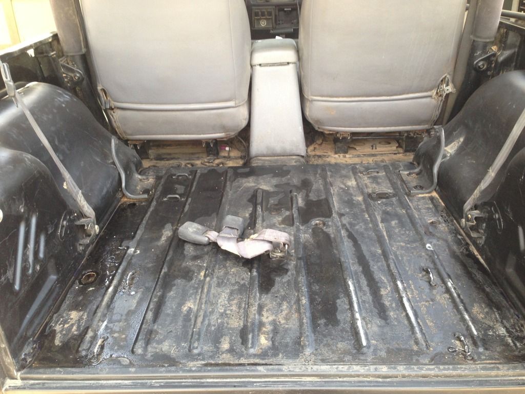

Before:
Stripped:
Chassis Saver:
Monstaliner (still wet):
BEETROOT is offline

That looks so good! Amazing how much it covers! Most of those dimples don't even show up. Can't wait to get time to do mine! Any week now. Still have not opened the can from the factory.
So, how long did it take yours to tack? You doing a second coat? How long did you wait? How long for the second coat to tack?

Thanks. I'm very happy with the way it came out. Love the product, love the color.
That picture is after the second coat. I waited about 90 minutes after the first coat then I started going over the small stuff again. It was probably 2 1/2 hours before I used the roller for the second coat.
I'm in Phoenix though and it was 108 today. Definitely helped speed the drying process along. I left the house for a few hours after the second coat so I'm not exactly sure drying time on that. It feels completely dry now, about 4 hours after the second coat.
