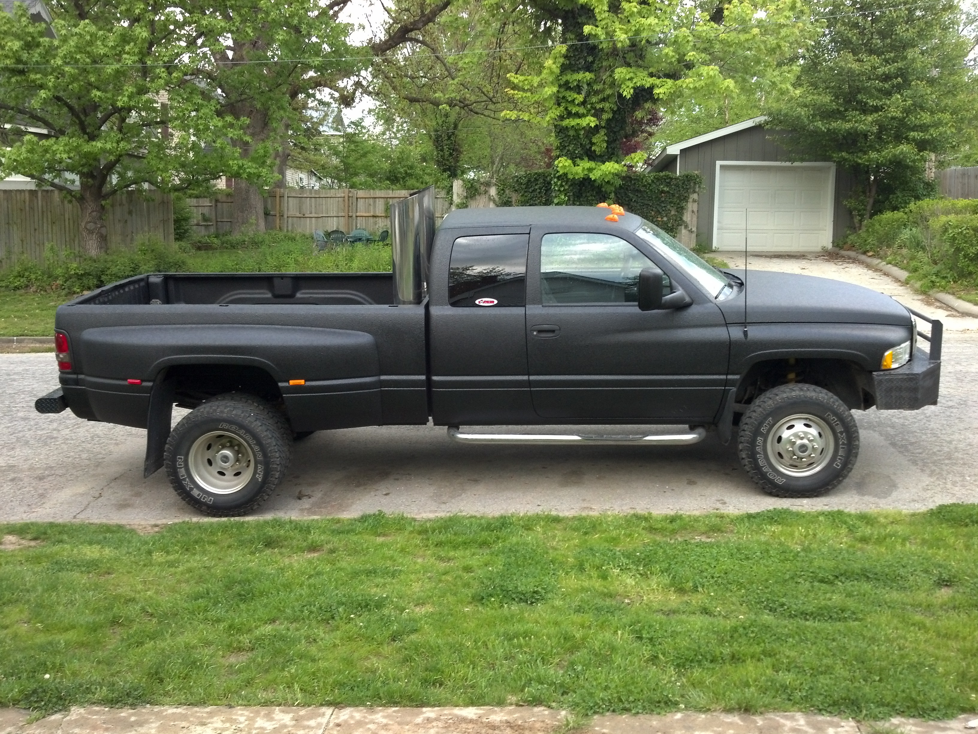

79 Scout
Rolled, ODG + BLK

Posts: 11,443
4 gallons BLK, Walcom sprayed
