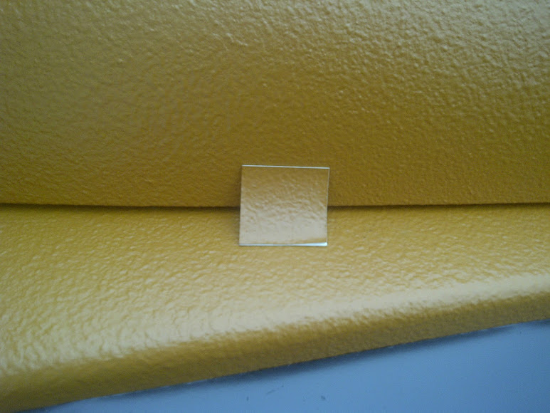

lynskynbnd
1987 YJ Wrangler
Location: warrenton
Posts: 179
Dark Burnt Orange
No picture looks the same as it does in person.
I think it's the light reflecting off texture, and phone cameras suck.
But the color sample is an exact match.
Still wet and in the sun
Dry and indirect lighting
indirect lighting on a different day
This is the closest match to what it looks like in person
Almost fully assembled....

post #10343 of 13493 Old 05-20-2013, 08:33 AM
pods8
Join Date: Feb 2013
Location: Boulder
Posts: 104
Hard to believe those are all pictures of the same color.
Order chips as they say!
pods8 is offline
