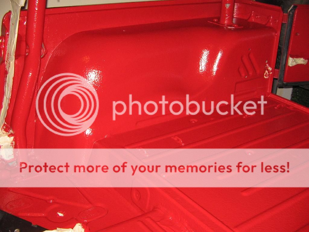

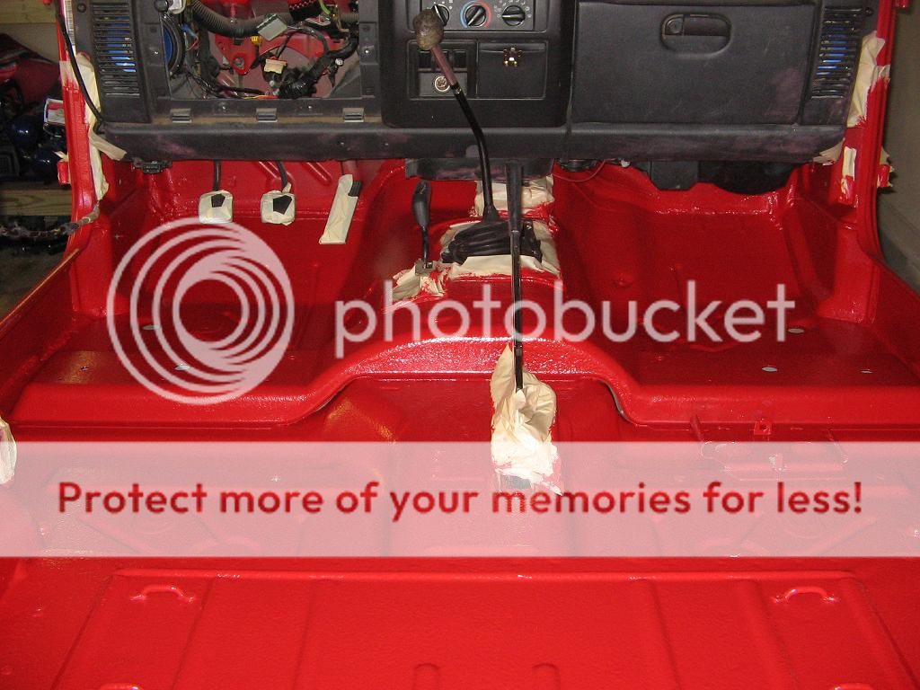

Gotter done today. I used my monsta bucket. I have applied alot of different coatings in the past 28 years and I have to say this coating is awesome.

After I opened the catalyst this song started playing in my head.

Originally Posted by Cuder View Post
Lady in red
Originally Posted by magnetman View Post
We should have called that color F**K ME RED
..................Written just like that ^^^^
You didn't notice the decal on the bucket? He says you're #1.
My Build Thread:
