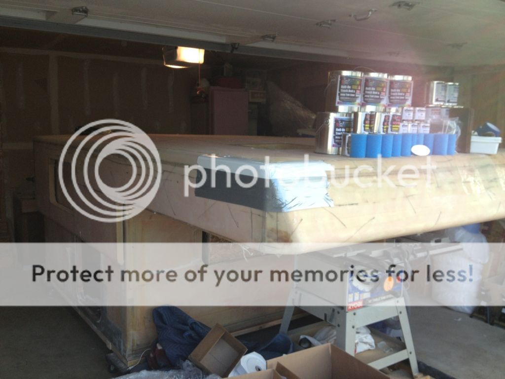

White monsta top done, light grey sides will overlap in the transition and raise the white color an inch or so. So the final cap will be a little less pronounced but this is the general look. Some thoughts:
1) On really flat featureless surfaces its hard to lay down 1gal/60sqft in two coats. For the 98sqft top I ended up mixing up a bit over 1-1/2gal total for the day. When we put down the second coat with full coverage we had 2/5 of the gallon full still. Ended up rolling out a "third" coat right away perpendicular to the second coat to use up the product which leads into item 2 & 3.
2) Doing the above started to tack up and work the roller near the end and I didn't notice the tiny tiny flecks of it coming off, I was expecting it to fall apart in larger chunks based on the impression I got from reading here. The reality is with the roller being translucent blue you have to get pretty close to pick them out and when this is on my truck the top is 7' in the air so live and learn there.
3) Rolling on more coating along the edges trying to use it up once things were getting tacky lead to a bit different texture that currently catches the light a tad so noticeable a bit (I presume it'll dull out more when it dries). Again 7' up normally, never going to see it.
So for my needs I can see I should start with a little less coating mixed up, can always mix more if needed, can't go the other way!
All that said it looks really nice for what I wanted out of this, can't wait to see the grey on the sides and get a picture out in the driveway to get the full view.

The top half of a hard sided pop-up truck camper I'm building for a truck with an aluminum flatbed. (Cabover walls will flip up into place).
P.S. See you're from Saginaw, I'm originally out of Bay City.
Here's a quick/crappy video of testing out the actuator roof lift (I rolled the camper part way thinking it'd auto rotate the video but it didn't so sorry about that, I'll get a better one eventually). http://s532.photobucket.com/user/pod...73603.mp4.html
Going on this (it will fit tigher to the cab verse my old camper, the flatbed is 3-4" higher than the factory bed but I took that into account when setting up the front wall height on this build):
