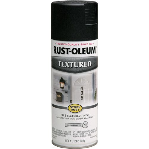

ok, My jeep interior has been scuffed and cleaned, 2 coats of rustoleum primer has been put down... Now its time for some Monsta!!!!
Magnetman, Do you suggest scuffing the primer as well prior to putting on ML?

Not necessary to scuff
Is that spray can or liquid primer?

its Rustoleum spray can...

Go for it
