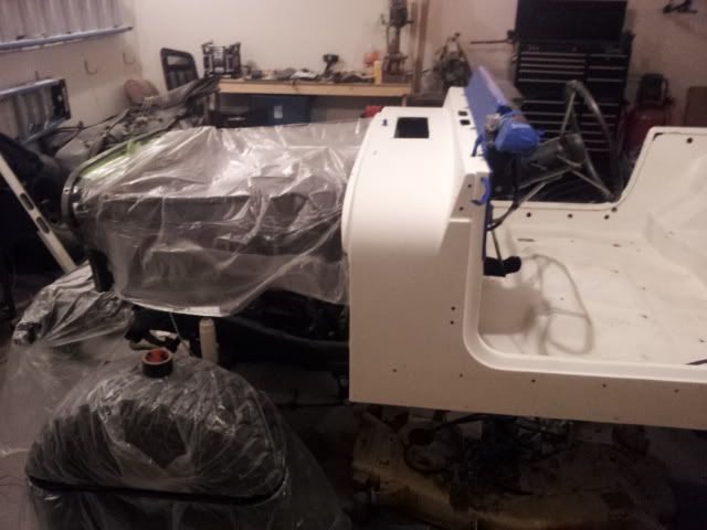

quick question, doing my exterior and interior on my cj, all fiberglass, im putting your universal primer on all fiberglass surfaces before i monstaline it, should i sand/scuff the primer before i do the monstaliner? thanks
latest pic of progress:
all sanding done, man does it suck lol, just have to finish masking off stuff and clean with mek, and wait for some warmer weather, then its time for primer!

Not necessary to sand the Universal Primer. Just keep it clean up to Monstalining. If desired, you can VERY lightly run a scuff pad over it right before ML and then use a tack cloth to remove dust. (If you tried to scuff it hard it will gum up you that's why it called a non-sanding primer)
