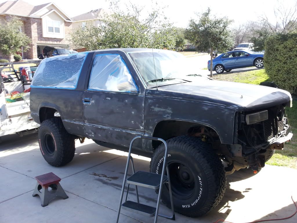

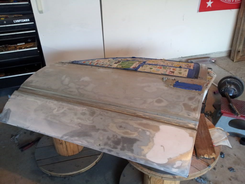

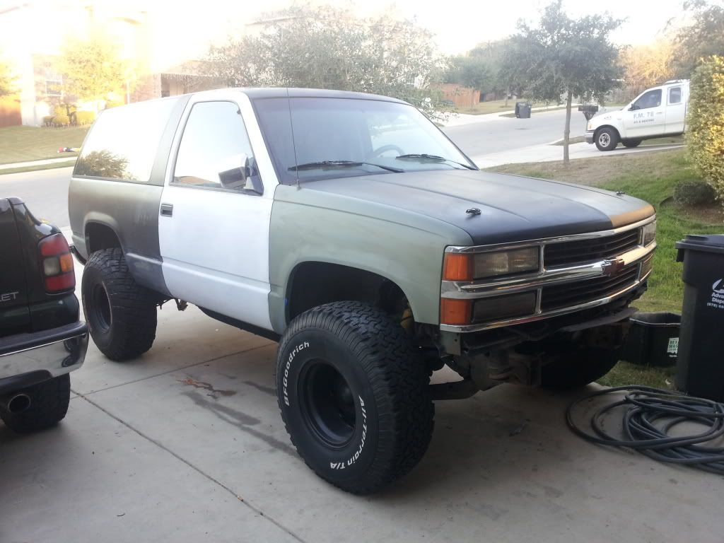

i believe i can answer your question regarding dents as my yukon had some when i sprayed it . this does not spray thick enough to cover dents. i did some bondo on the bigger stuff and those areas covered PERFECT even though the bondo job was not feather sanded over and over like it would be for a traditional paint job , smaller dings and dents however if they are bigger than a quarter will show.
