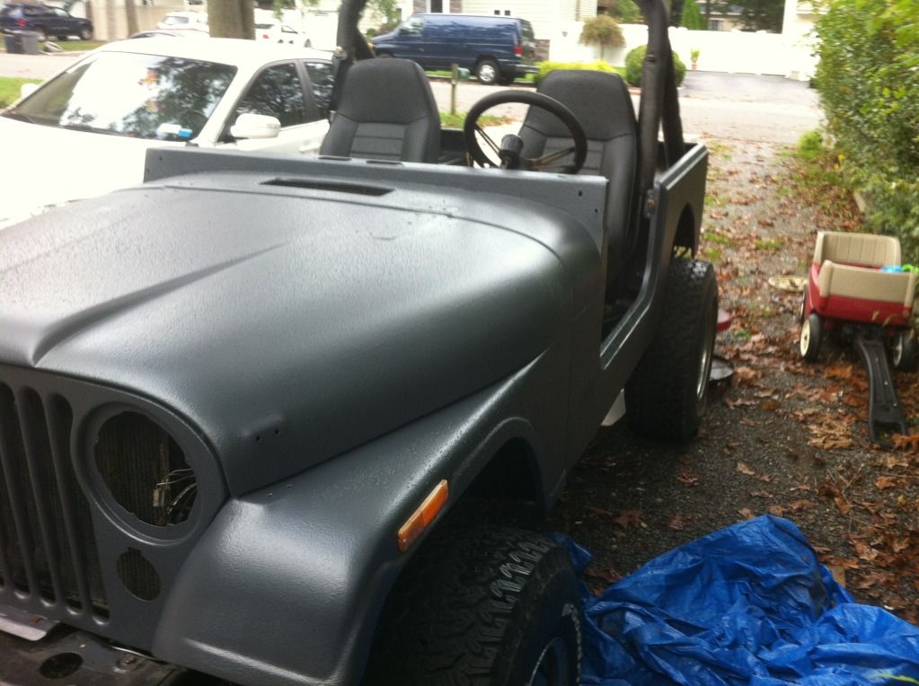

I rolled the whole exterior and it took about 3 hrs on a 65 deg day with about 75% humidity. The tintable dries ALOT faster than the black. I had about 1 hour between coats compared to when I did the inside of the tub with the black and I had a good 3 hours. To my surprise, I was able to apply two thick coats over the entire body with 1 Gallon and I had about a cup left. I still have a whole gallon kit leftover. I assume it covered so well because it was applied over grey epoxy primer. Over all, I am thrilled with the results. The texture is perfect. Smooth enough to not trap dirt but rough enough to offer protection.
