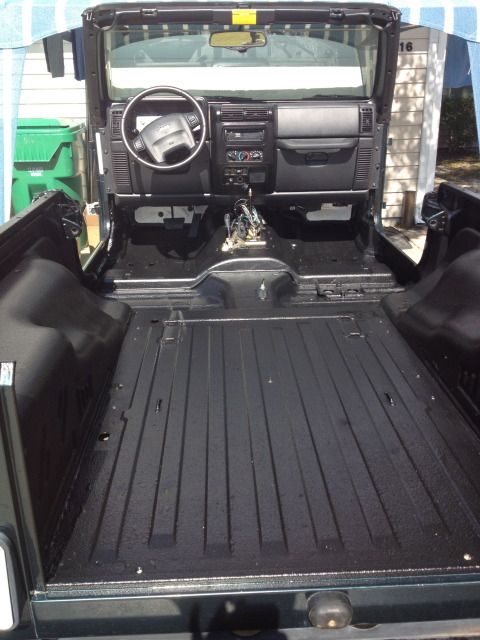

Well it's done! And thank god! What a pain that was! Overall I am satisfied with the turn out and of course there are some spots that could have better coverage or that were missed altogether! I am now just waiting the cure time and need my jeep tomorrow so I will only be installing the roll bar and my seat everything else will wait a few days. I will also try and get some pics up today. If I had it to do all over again or have to do another jeep then I will be spraying it on! The jeep has some unusual spots that are hard to get with the rollers and the turn out isn't the greatest with just a brush. But if you ask me spraying is the only way to go!
Great. I've sprayed a CJ and have rolled it on...the spray is nothing like spraying paint but is great for the hard to reach areas. Rolling gives a much better texture, smoother, and if you are doing it in a garage, a whole lot less prep to roll . Congrats anyhow

Posts: 290
Well here are the pics as promised.
I think the only thing that was bad was the roller started to come apart and got some foam in the liner, but oh well. Like I said before, If I have to do another jeep I will be spraying over rolling! And does anyone know what process is involved if I want to put another gallon down on the ML thats in place?
ospreyfe55 is offline

I believe that after it is cured you have to scuff sand and MEK wipe down then Coat. I am sure someone else will verify or correct. It looks good.
