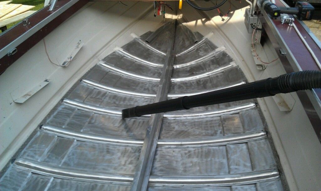

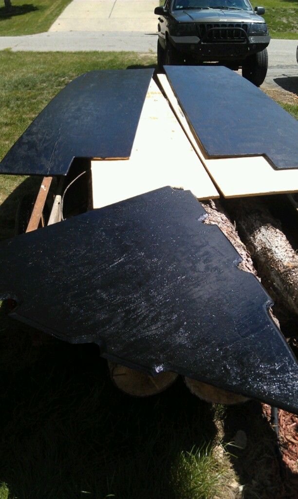

Got EP from Napa as suggested. Wire wheeled (low speed) the aluminum surface and applied two coats. I just read where you mentioned to somebody else to scuff if CS is applied to the EP after 2 days. Right on the money. I went by the directions on the EP can that lead me to believe it would be a little longer. I had a 3 day lapse and there were a couple, little, spots that appeared to want to bead up and not adhere so great. Fortunately those 2 areas weren't close to any seams or rivets. 2nd coat of CS covered everything completely. Also got the plywood floorboards coated with their first coat of CS. The void in between will get foamed. So not worried about those two spots being scuffed away or anything. Will know better next time.
Just ordered 2 more cans of CS last night. The two I used were reserved for jeep use. Gotta do the exterior of the boat hull yet. Gonna hit a local vender for another quart to get the floorboards finalized tonight. Want to get the interior done befor labor day. I did get some pics, but left phone in the jeep. I'll get them up later.
Originally Posted by magnetman View Post
"I'm here til 6:30 tonight and off tomorrow to start on this. Unless you have a specific suggestion, I'll hunt for the epoxy primer tomorrow get to brushing. I'll take some pics."
NAPA parts stores usually have 2 quart kits of epoxy primer
Light scuff aluminum first and solvent clean with acetone or MEK
And don't listen to anyone in parts stores when they look at you funny and say you have to spray this stuff

Boat hull after MEK and scuffing.

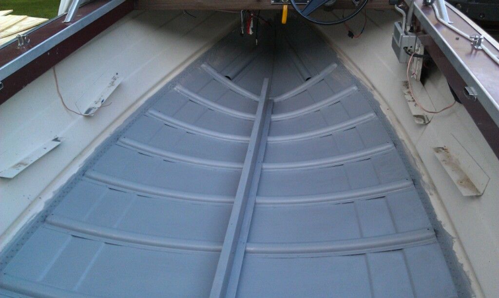

Epoxy primer brushed on.

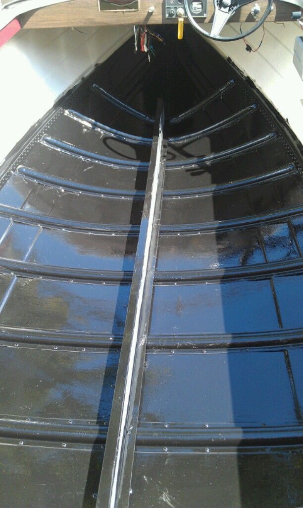

1st coat of chassis saver.

Floorboards and hull have since recieved a 2nd coat. Installing some additional aluminum frame for the floor, then foam packing. Floor will get carpeted after install, and then seats and side boards.
